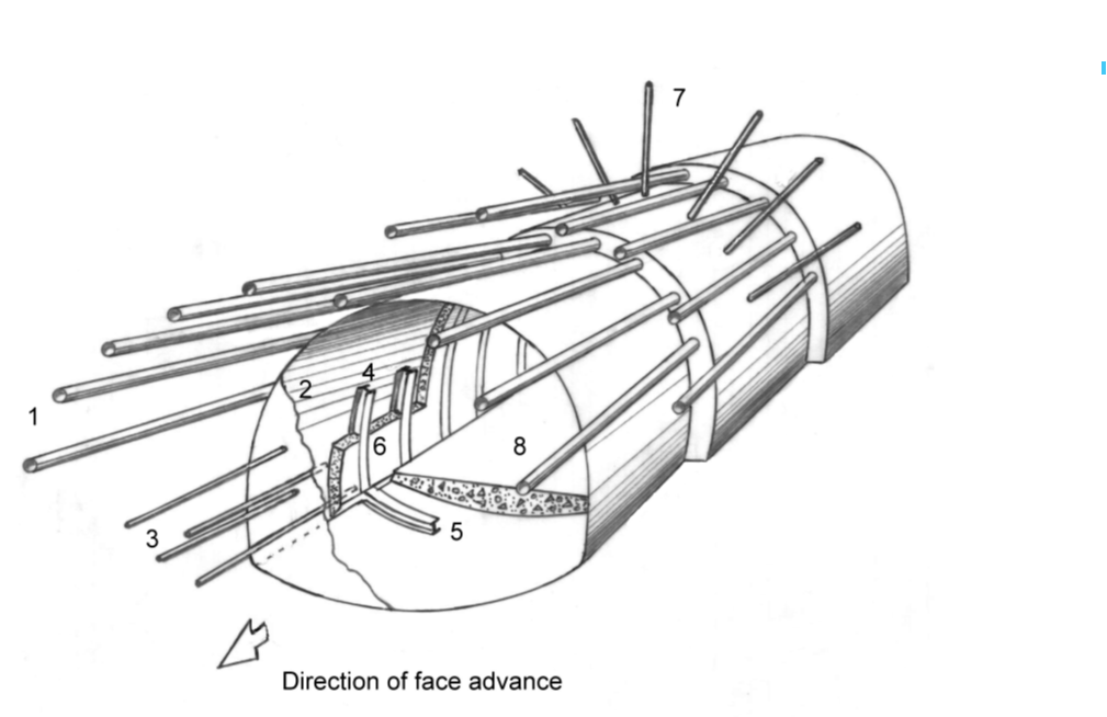

Figure 1 summarizes one possible method for driving a tunnel through squeezing ground. To illustrate the numerical FEA work that would be considered for such a case, a set of modelling procedure is described in PLAXIS 3D, and comments are provided on the assumptions made and the reliability of each step. In the present situation, the invert struts (#5) and the invert lining (#8) will not be considered in the framework of the present analysis.
1 Forepole pipes
2 Shotcrete – Initial coat
3 Grouted fiberglass dowels
4 Steel sets
5 Invert struts
6 Shotcrete lining
7 Rockbolts
8 Invert lining
