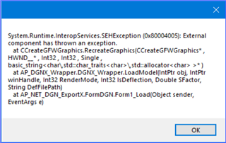

While trying to export a file to DGN with "Deflected Model Graphics" option enabled, the following message appeared:
System.Runtime.InteropServices.SEHException (0x80004005): External component has thrown an exception.
   at CCreateGFWGraphics.RecreateGraphics(CCreateGFWGraphics* , HWND__* , Int32 , Int32 , Single , basic_string<char\,std::char_traits<char>\,std::allocator<char> >* )
   at AP_DGNX_Wrapper.DGNX_Wrapper.LoadModel(IntPtr obj, IntPtr winHandle, Int32 RenderMode, Int32 IsDeflection, Double SFactor, String DefFilePath)
   at AP_NET_DGN_ExportX.FormDGN.Form1_Load(Object sender, EventArgs e)
OK
Why and how to avoid he issue?
In this particular model, the model was round tripped (918691) and followed round trip instructions to thoroughly review the model and comparison checks. The model now exports a file with deflected load case.
