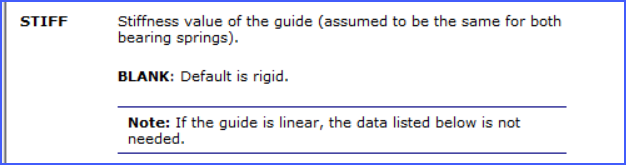

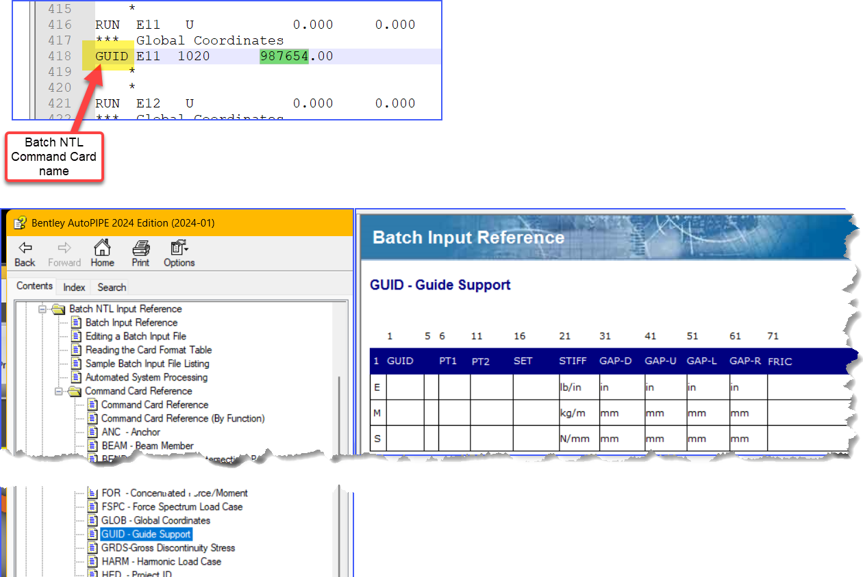

5. How to find the command card for a specific setting in an AutoPIPE model?
