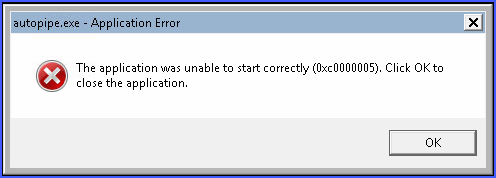

Q. "Error 0xc0000005:" displayed in log file when installing AutoPIPE
Product(s):AutoPIPE
Version(s):ALL;
Area: Installing
Date Logged
& Current Version
April. 2018
11.03.00.08
When trying to install AutoPIPE, an error message message was found in installation log file:
Faulting application name: autopipe.exe, version: 11.3.0.8, time stamp: 0x5ac26bcc
Faulting module name: InProcessClient32.dll_unloaded, version: 0.0.0.0, time stamp: 0x5ace71c4
Exception code: 0xc0000005
Fault offset: 0x745ef920
Faulting process id: 0xf04
Faulting application start time: 0x01d3ebd8de080e1d
Faulting application path: C:\Program Files (x86)\Bentley\AutoPIPE CONNECT v11\autopipe.exe
Faulting module path: InProcessClient32.dll
Report Id: 1c219e17-57cc-11e8-a96c-54e1ad30bb6a
Or
InProcessClient64.dll. appears
OR
Why does this occur and hod best to avoid it.
