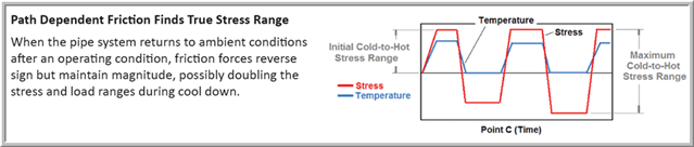

Friction is often ignored or not easily understand across many industries. If in doubt companies will apply a nominal friction factor = 0.3, but some industries like Nuclear typically ignore friction. It is well documented static friction factors between steel on steel can vary from 0.3 to 0.8 but as industry consultants like Dr Tony Paulin state below the true stress range from Cold to Hot to Cold causes the friction forces to reverse and thereby doubling the frictional stresses in the pipelin. Since pipe stress programs analyze only a Cold to Hot or Hot to Cold range, some companies to capture this increased stress due to friction forces double the steel on steel friction factor to 0.6.

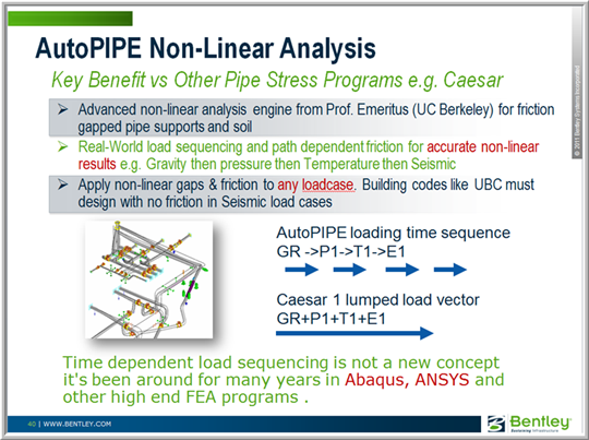

Imagine friction "building up" on the piping after thermal load. It hasn't broken friction or closed a support gap yet, but it's building up to that point of doing so. Wind or seismic just gives it that little push to break friction and or close the gaps, but it does require that extra 'push' to make it happen. Therefore, the boundary conditions change, but only AFTER the wind load hits, so boundary conditions are different between the thermal and wind load analysis. This is only captured using a Non-Linear incremental approach and not Total Loads approach.

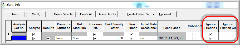

III. Should we Consider Friction forces for Seismic Loads?
Note: It is not uncommon in fact and stated by many building design codes like UBC and IBC that friction should NOT be considered for occasional type loads like Seismic. This is only possible using an incremental load case analysis engine like AutoPIPE when other non-linear conditions like support gaps need to be considered. AutoPIPE has an option to ignore friction for seismic ('E') and/or gravity load cases.
Friction is calculated as friction factor x bearing force. The vertical or lateral support bearing force (hence friction) changes for each different load case applied by the piping on the support. Of course the lateral bearing force is also dependent on the support gap which is changing by load case.
The Total Load approach like with Caesar does not understand the boundary conditions and bearing force (hence friction) are changing by load case i.e. path dependent friction. It assumes constant boundary conditions from one Total load vector to another e.g. GR+T1+P1+E1 compared to GR+T1+P1 which is incorrect.
1. Reference: Dr Tony Paulin Webinar February 2012 "New Pipe Stress Capabilities in PCL Gold"
Discussion of the importance of path dependent friction.
Extract Paulin Research at 5/3/2012
http://www.paulin.com/library/prg2009featureslist.pdf

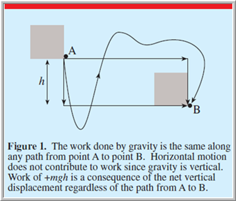

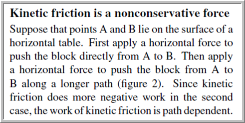

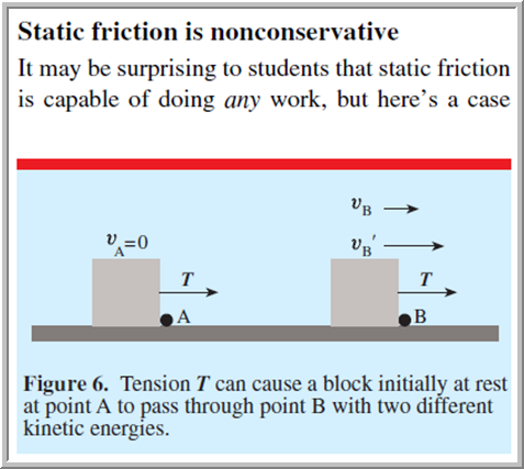

2. Reference: The common forces: conservative or nonconservative? (2006)
By David Keeports
Department of Chemistry and Physics, Mills College, Oakland, CA 94613, USA

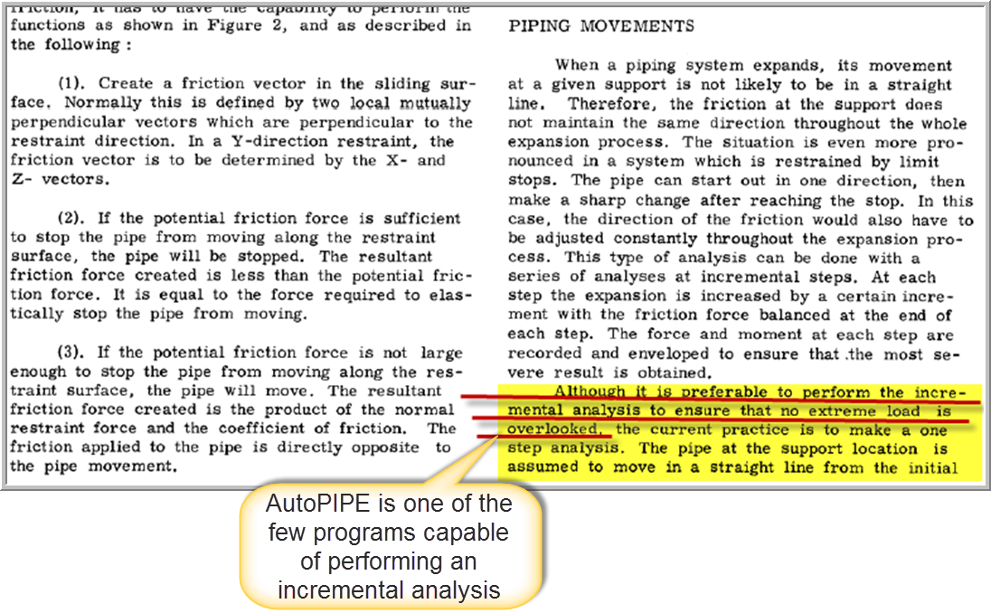

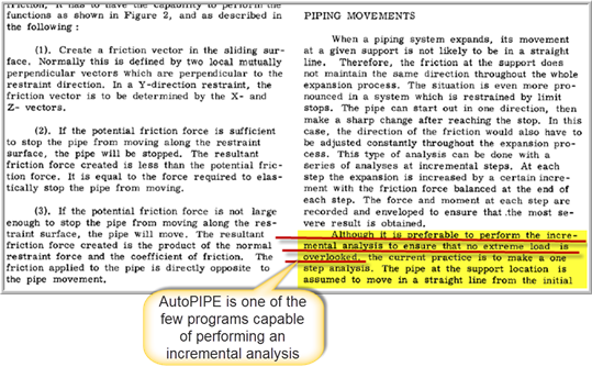

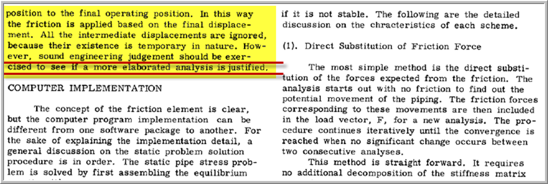

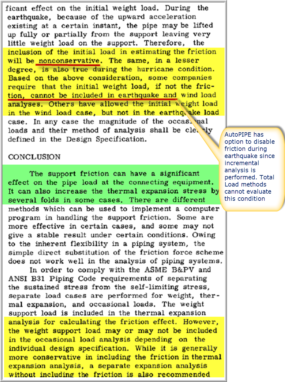

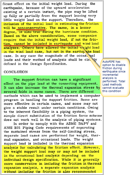

3. Reference: TREATMENT OF SUPPORT FRICTION IN PIPE STRESS ANALYSIS (1989)
By
Liang-Chuan Peng
Pang Engineering
The author has stated in a couple of highlighted sections it is preferable to perform incremental analysis such as in AutoPIPE, “to ensure no extreme load is overlooked” the complication of the support stop and the friction has to be adjusted.
Most pipe stress programs like Caesar use an old total load approach as described in ref 5.

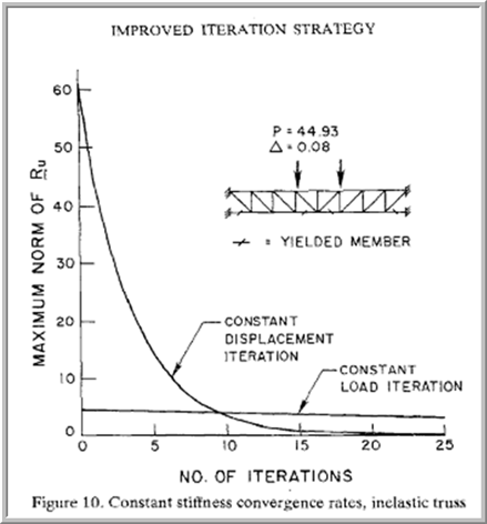

4. Reference: IMPROVED ITERATION STRATEGY FOR NONLINEAR STRUCTURES (1981)
By GRAHAM POWELL AND JEFFREY SIMONS
Department of Civil Engineering Division of Structural Engineering and Structural Mechanics, University of California
AutoPIPE is based on advanced displacement increment method
developed and published from the University of California (Berkeley)
