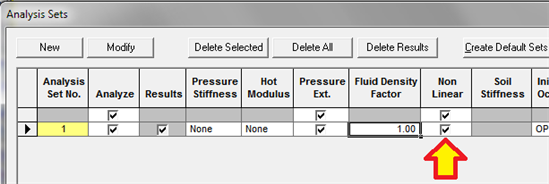

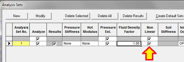

How to perform a Non-Linear Analysis?
On the Static Analysis Sets dialog screen, enable boxes in the "Non-Linear" column
OR
Select an Analysis set and press the Modify button to open the dialog. Where he option "Gaps/Friction/Soil" can be enabled / disabled as needed and press OK button.

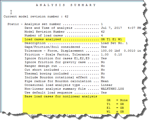

Review Analysis Summary output report:
Here one can clearly see that the Load Cases analyzed are Gr, T1, E1, and W1. Also that the load sequence was:
1st, analyze load case GR.
2nd, from the displaced pipe location due to Gravity, add load case T1.
3rd, again, from the displaced pipe location due to Gravity, add load case E1.
Lastly, again, from the displaced pipe location due to Gravity, add load case W1.

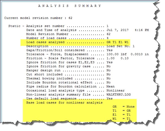

Conversely, pipe displacement and support load results can be significantly different if the Wind loads were applied to a piping system that had already been displaced by operating conditions, example OP1:
Again, one can clearly see that the Load Cases analyzed are the same: Gr, T1, E1, and W1. However, notice the load sequence is now different:
3rd, again, from the displaced pipe location due to Gravity + T1, add load case E1.
Lastly, again, from the displaced pipe location due to Gravity + T1, add load case W1.

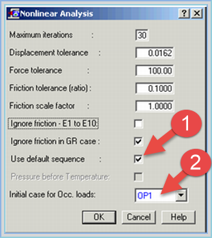

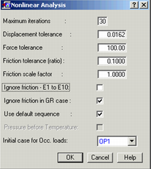

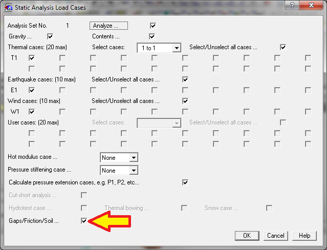

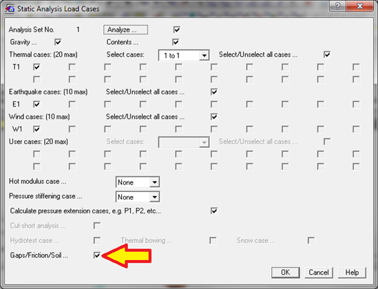

How to define Non-linear options?
Only by opening the Static Analysis set dialog, enabling the "Gaps/Friction/Soil" checkbox and pressing OK button, will the NonLinear Analysis dialog appear (refer to program help for details on this dialog screen).
Note:  Why does NonLinear Analysis provide the following options on the dialog above:
“Ignore friction GR”
"Ignore friction E”

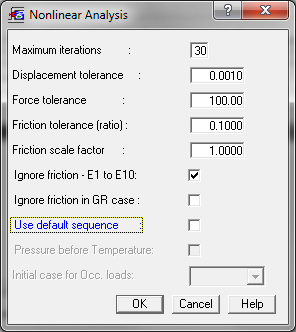

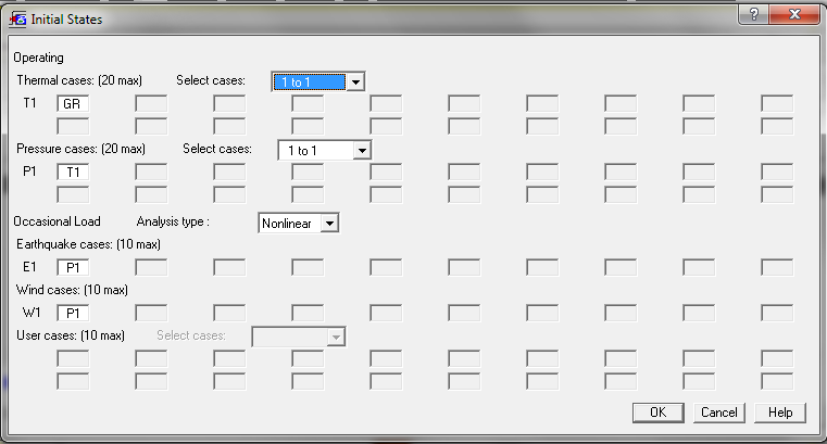

How to control load Sequence?
There are 2 settings to control load sequence both options are accessed by Non-Linear Analysis options dialog mentioned above.
1.Initial case for Occ. loads
2. Use default sequence
For more complicated load sequence, uncheck the "Use Default Sequence" box to modify the Load sequence and press OK button as shown below:
Now manually adjust the load sequence as needed. There are some limitations to load sequence:
1. Initial state for occasional load cannot be another occasional load case.
2. Initial state for occasional load cannot be a User load case.
3. Initial state for User load cannot be another User load case.
etc...
