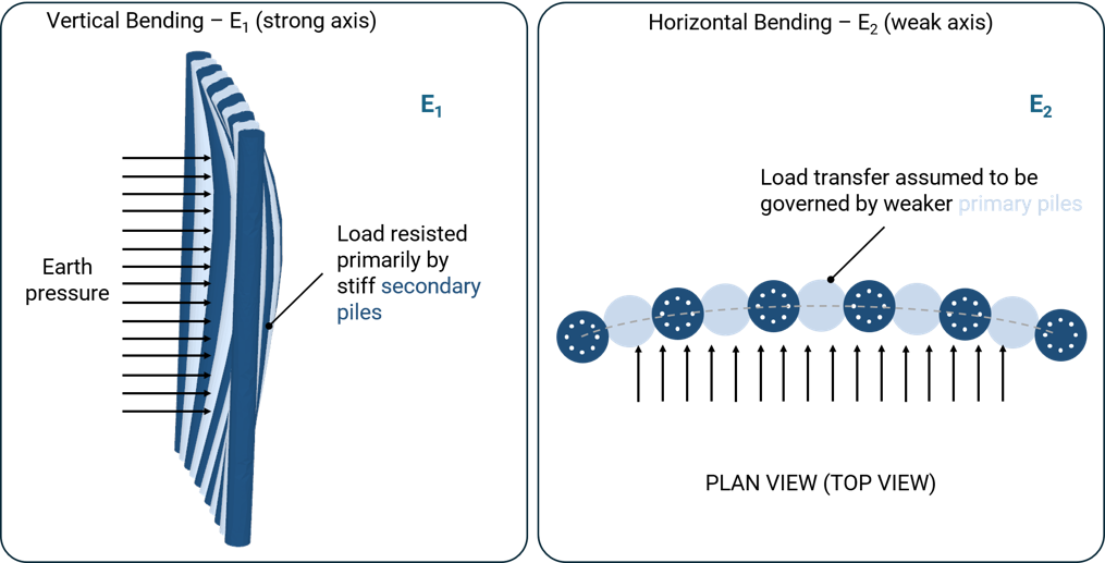

4. Estimating E2 — Horizontal Bending Stiffness
The E2 formulation is not contained in CIRIA C760. It is proposed as a practical engineering approximation for orthotropic PLAXIS 3D plate modelling. In 2D plane-strain analysis, horizontal bending along the wall is not normally represented. In 3D, however, direction-2 bending may influence behaviour at corners, re-entrant geometry, and changes in alignment.
Conceptual load paths for bending stiffness
Figure 3. Conceptual load paths governing vertical and horizontal bending stiffness in a secant pile wall.
A conservative lower-bound estimate for horizontal bending stiffness may be obtained by assuming that the weaker primary piles govern the effective response along the wall. This is not a rigorous homogenisation result; it is an engineering approximation intended to avoid unconservative overestimation of stiffness in direction 2. EI2 per unit width ≈ Eprim · Iprim / s E2 = 12 · Eprim · Iprim / (s · deq3)
Recommended sensitivity range: For critical applications, vary E2 between a conservative primary-pile lower-bound estimate and a higher stiffness justified by composite action, calibration, or comparison with explicit pile modelling. The selected value should reflect the assumed degree of interaction between adjacent primary and secondary piles.
