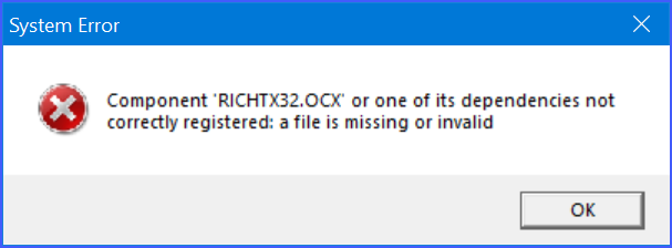

The following appears when trying to start AutoPIPE Nozzle.
System Error
Component 'RICHTX32.OCX' or one of its dependencies not correctly registered: a file is missing or invalid
OK
Why and how to avoid it.
Why and how to avoid it?
1. close AutoPIPE Nozzle applications and windows related to.
2. Download RICHTX32.OCX from a reputable source.
3. After downloading the file (unzip if necessary) and place the file into the appropriate windows folder:
- 32 bit system type:
C:\Windows\System32
- 64 bit system type:
C:\Windows\SysWOW64
4. Next, start the command line as an administrator in Windows by pressing Win key on your keyboard and typing "Command Prompt" in the search field, then - right-click on the result and select Run as administrator.
5. enter the following at the command prompt
regsvr32 C:\Windows\System32\msstdfmt.dll
regsvr32 C:\Windows\SysWow64\msstdfmt.dll
If successful, the command prompt will appear.
6. Restart AutoPIPE Nozzle and continue to use the program
