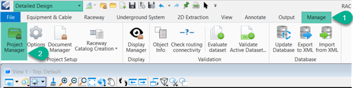

4. From the Manage Tab, select Project Manager.

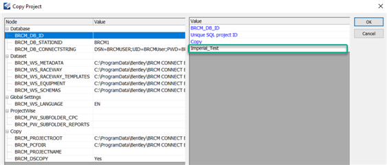

5. Project Manager dialog box will appear. Right-click anywhere on the left-hand pane of the Project Manager dialog and select Copy Project. The resulting Copy Project dialog will look very similar to Project Manager.
6. Click the row for BRCM_DB_ID in the left pane. In the right pane, specify a value in the Value field that follows the Rules for Regular Identifiers. (For Example: Imperial_Test)
7. Click the row for BRCM_ PROJECTNAME in the left pane. In the right pane, specify the desired folder name for the project the Value field (For Example: Imperial_Test) and Click OK.

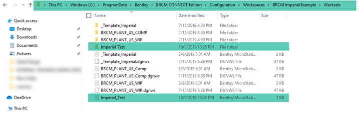

10. By looking at the WorkSet folder by the file manager, there will be the Project Name folder with its config. file.

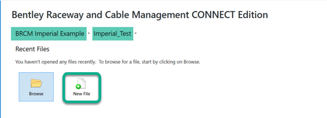

11. Open BRCM again and select the project WorkSet that was created.

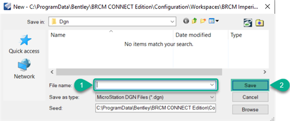

12. Click on New File to create New DGN in it.
13. Specify the File Name and Click Save.
14. The specified file name DGN will open.
