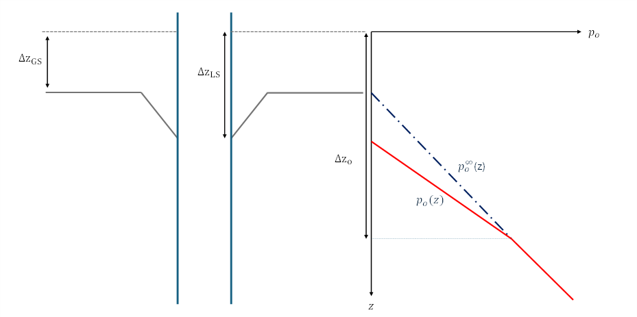

Pile 3D – Pile Local Scour
Support for local scour definition has been added to Piled3D. Local scour for individual piles may be entered in the pile definition line (PILE) with default values for local scour depth and overburden pressure reduction depth as suggested by API 2GEO or with manual definitions. This feature will reduce pile stiffness to zero in the local scour region and optionally reduce overburden pressure according to API 2GEO section C.8.5.

- 1722041 - Added pile local scour support to Pile3D. This feature may be used to reduce pile lateral stiffness in the area of the local scour and reduce overburden pressure according to API RP 2A for soil stiffness calculations beneath the scour region. See the PSI/Pile documentation for more details.
