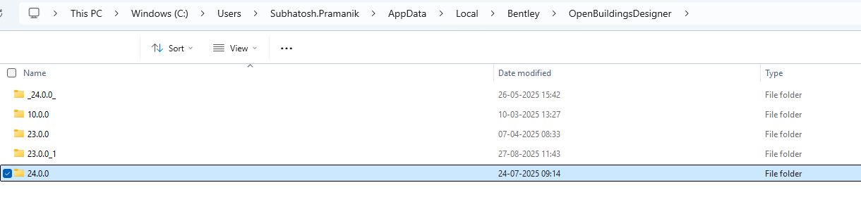

2. Go to "C:\Users\Your.Name\AppData\Local\Bentley\OpenBuildingsDesigner\" and copy the folder named "24.0.0" if you are using OBD 2024.

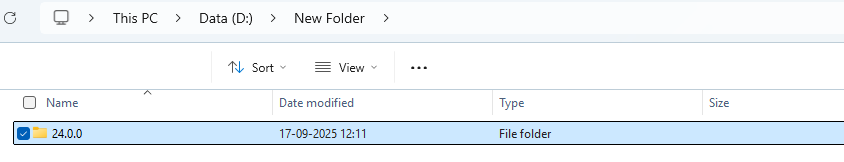

3. Paste this folder inside your preferred location which is the "New Folder" inside the D drive in this example.

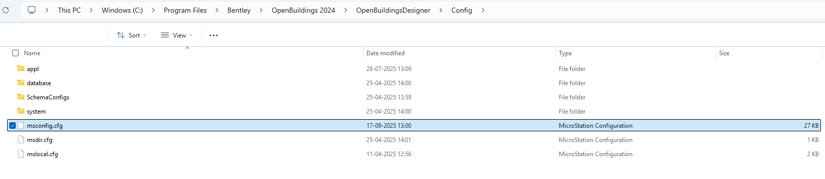

4. Go to "C:\Program Files\Bentley\OpenBuildings 2024\OpenBuildingsDesigner\Config\" and open the file named "msconfig.cfg" using any text editor like Notepad or Notepad++ etc.

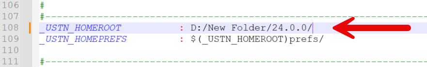

5. Scroll down to find the configuration variable "_USTN_HOMEROOT" and assign its value to "D:/New Folder/24.0.0/" as shown in the following screen grab.
Make sure to put forward slash ( / ) while defining the folder location.
6. Save the changes to the file and close it. Note: You might need admin privileges to make modifications to this CFG file.

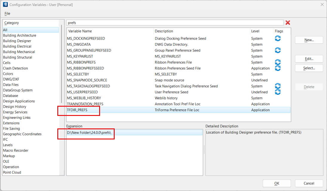

7. Launch OBD 2024 and check the Configuration Variable "TFDIR_PREFS" to make sure that you are directed to the correct prefs folder.
