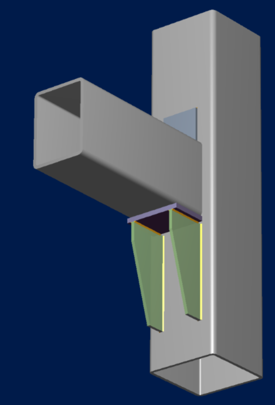

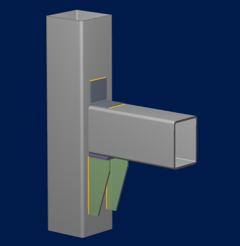

1. New Stiffened Seated Connection for High Shear Forces Between HSS Beams and HSS Columns. A new Stiffened Seated Connection has been introduced to address high shear forces for HSS (Hollow Structural Section) beam-to-column connections. The vertical stiffener plates transfer vertical shear to the column while the horizontal seat plate can be welded directly to the HSS column to transfer horizontal shear as shown below.
Figure 1. New stiffened seated connection for HSS beams and HSS columns

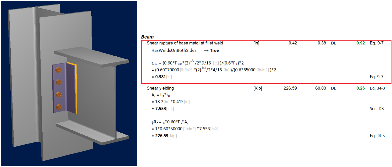

2. AISC Weld Capacity Check for Weld Size Based on Strength of Connecting Element. A separate capacity was added to all welded connection to check weld size based on the strength of the connecting element. This verification ensures that welds not only meet load requirements but also align with the capacity of the connecting elements.
Figure 2. Weld Capacity Check for Weld Size Based on Strength of Connecting Element

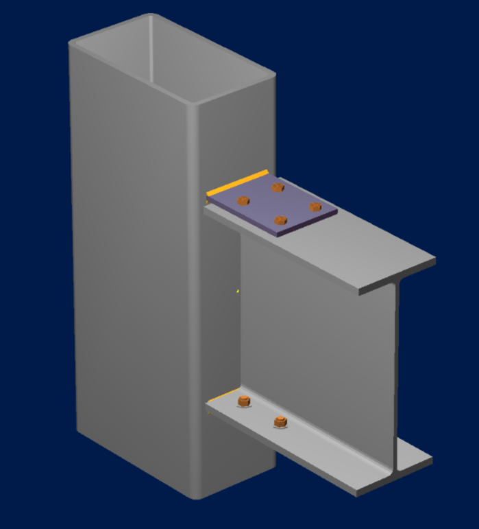

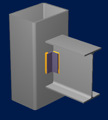

3. Expanded Support for Cleat Angles and Flange Plates on Tubular Columns (AS-CSA-NZS). RAM Connection now expands support for cleat angles and flange plates on Hollow Structural Section (HSS) columns across AS, CSA, and NZS standards, addressing a common user need for flexible connection designs beyond the traditional I-section column limitations.
Figure 3. Flange plate and cleat angles welded to tubular column

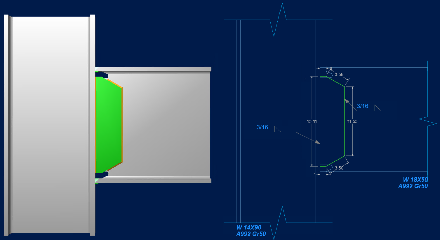

4. Enhancement for AISC Welded Unreinforced Flange-Welded Web (WUF-W) Moment connection. A seismic shear plate was added to the directly welded connection to complete the WUF-W prequalified seismic connection according to the AISC 358-22. All welds and geometric limitations were included for the shear plate. This option is only available when seismic provisions are considered and the moment frame is defined as IMF or SMF.
Figure 4. WUF - W moment connection including the shear plate
