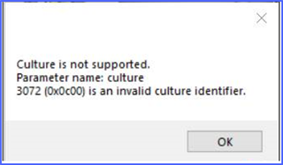

03. Culture is not supported (3072 (0x0c00))... message appears when generating a report in AutoPIPE
Product(s):AutoPIPE
Version(s):ALL;
Area: Report
Date Logged
& Current Version
Oct. 2020
12.04.00.13
The following appears when trying to generate a report:
Parameter name: culture
3072 (0x0c00) is an invalid culture identifier
Why and how to avoid?
 The problem is directly related to the computer Region settings. See WIKI here for proper region settings.
