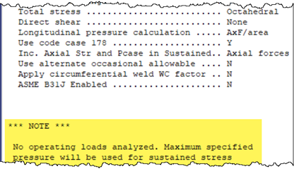

Why note "No operating loads analyzed..." appears after the CODE COMPLIANCE setting in the Analysis summary report of AutoPIPE?
"No operating loads analyzed. Maximum specified pressure will be used for sustained stress."
In one of the configured Analysis sets, there are no enabled Temperature load cases. Consequently, this note serves to inform the user that the maximum pressure will be utilized for the Sustain combination.

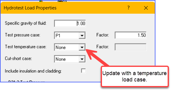

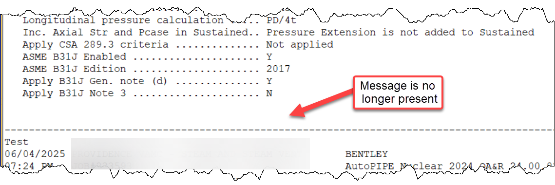

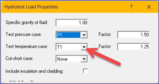

Solution #2:
Update Hydrotest Load Properties with a Temperature Load case selection:
