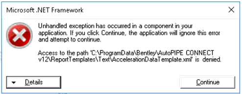

When trying to review the results grids, the following message appears:
Why and how to avoid?

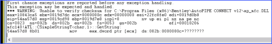

WINDBG file revealed:

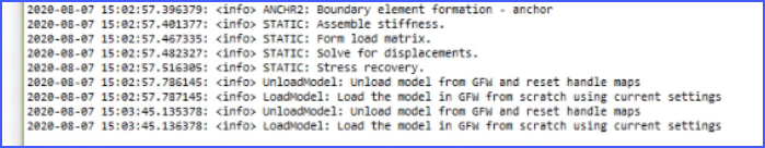

AutoPIPE Log file revealed:
In this case, the answer was directly related to missing files:
Open the following folder location:
C:\Program Files (x86)\Common Files\Microsoft Shared\DAO
The folder should contain one or more of the following:
dao350.dll
dao360.dll
DAO2535.TLB
After coping these files to this folder and restarting the computer the issue was resolved.

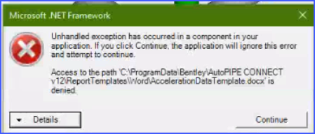

Example #2:
The following was displayed in AutoPIPE when  trying to create an output report:
Reason, user did not have read write permission to the folder indicated in the message above. After providing user permission to the profile folder the warning was no longer displayed and the user was able to create an output report.
