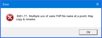

E801-77: Multiple use of same THP file name at a point. May copy and rename... message appears when
Product(s):AutoPIPE,
Version(s):all
Area: error message
The following appears when Analyzing > a time history:
Error
OK
What should I do to avoid this issue and be able to run the analysis?

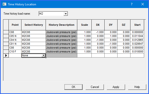

As mentioned on the dialog there is a time history location file that has one or more node point name occurring 2 or more times with the same time history profile file.
Question: can you identify what is wrong in the following screen shot and how to fix it?
Answer: Correct, node point C08 occurs 2 times and has the exact same history file specified (ex. M2C08).
Also, correct, all one needs to do fix this issue, choose:
a. Completely remove one line where C08 is defined
or
b. Choose one C08 line and redefine a Different History file.
