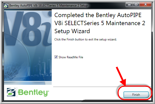

Step #6: Scroll down a few pages in the document to see a listing of screen shots that will be presented, ending with pressing the Finish button, shown below:
