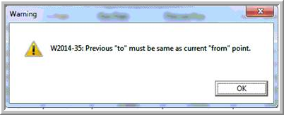

W2014-35: Previous "to" must be the same as current "from" point. warning message in AutoPIPE

The following appears when using the Fluid Transient dialog:
How to fix it?

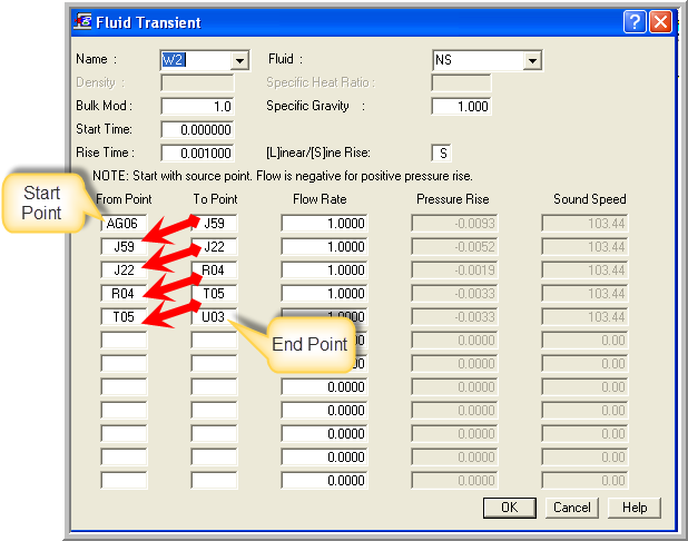

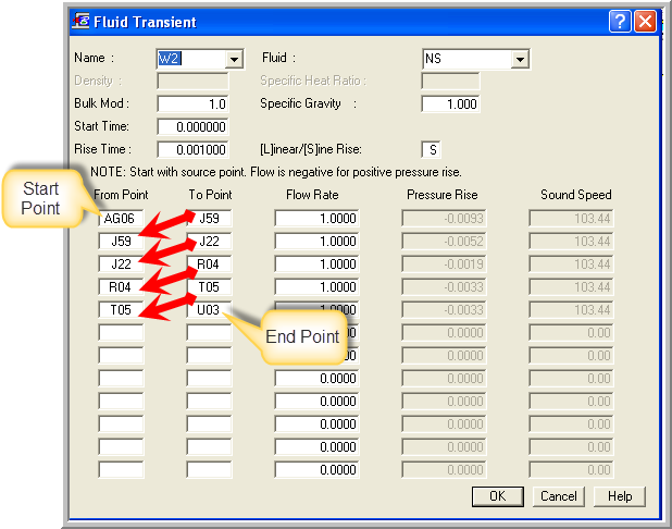

 Essentially the Fluid Transient path is entered from start point point to the next point, from that point to the next point, from that point to the next point, so on to the last node point where the transient ends, as indicated below:

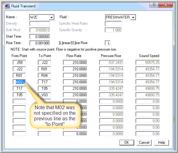

The warning message appears when there is an inconsistent path then describe above, example:
Sometimes this issue can occur in a model after deleting a node point that was part of an existing Fluid Transient Path and then opening the Fluid Transient dialog to review an existing transient's settings (logged under TFS-D185135).
Avoidance:
Open the Fluid Transient dialog and update the path name with the correct information, example: replace M02 with R04 in the image above.
If this does not solve the issue, perform Model Compaction, and then enter the fluid transient dialog. User may need to recreate a new Fluid Transient of an existing transient.
