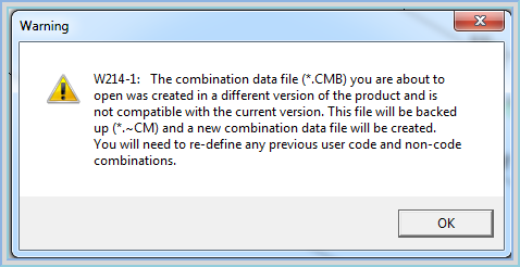

The following message appeared in AutoPIPE:
Warning
W214-1: The combination data file (*.CMB) you are about to open was created in a different version of the product and is not compatible with the current version. This file will be backed up (*.~CM) and a new combination data file will be created. You will need to re-define any previous user code and non-code
combinations.
OK
Why and how to avoid it?
As the message mentioned, this current combination file (*.CMB) was created in a different version than is currently being used. This is typical when opening an AutoPIPE model created by a higher version than is currently being used.

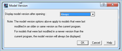

2. In AutoPIPE select Tools> Settings> Model Version> set to Always
3. Re-open the file

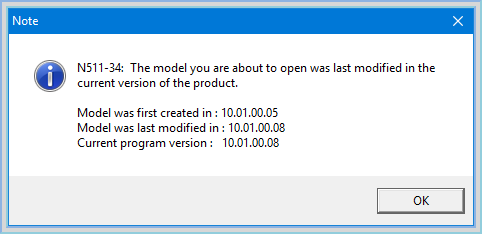

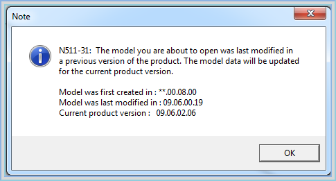

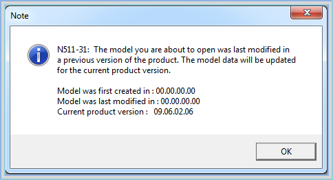

4. A dialog should appear notifying the user what version the model was first created, last version that modified the file, and the current version being used.
Example:
5. Is the Las modified version higher than the Curent Product version?
Does the Last modified version or First created version have ** or  00 at the beginning of the version number?
If answer = Yes for one or both questions, than this is an indicator that the current version of the program is not correct and there are possible errors with the current database file.
Note: the Current Product version should always be the same or higher that the Last Modified version

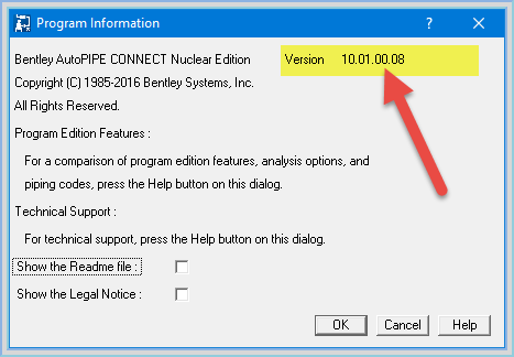

a. In AutoPIPE, select Help> About> upper right hand corner see current program version.

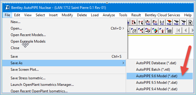

b. Contact the person who last had the model opened, ask that they reopen it in their version and than use File> Save As> select your version. This will generate a file with the version extension:
Example
c. Ask that they then send you that file.
