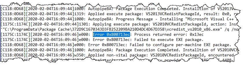

User with Administration right to the computer is attempting to install AutoPIPE, while going installation process the application suddenly crashes / fails.
After the installation abort, the following was found in the error log file:
Error 0x800713ec: Process returned error: 0x13ec
Why is this happening and how to Avoid it?
