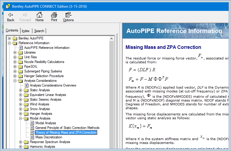

In cases where the dynamic load is applied very near a support or directly at the support as in case of imposed support displacement history or axial fluid transient loads, the support reaction may be near zero or very much less than the actual reaction. The reason can be because the mode shapes involving the movement between the applied load direction and the support point were not computed as specified by the number of modes or cut-off frequency. These missing mode shapes are usually very stiff and hence associated with mode shapes in the high frequency range. In such cases, an additional static earthquake analysis should be performed and the maximum reaction from both static and dynamic analyses should be used. This can be easily done by using the ZPA option which envelops dynamic results with equivalent static results. However, the ZPA method is an approximate one and not exact.  Zero Period Acceleration (ZPA) follows this procedure:
For more information on using Static Correction Methods, go to the AutoPIPE Help, Help > Contents >  Contents Tab > Reference Information > Analysis Considerations > Modal Analysis > General Principle of Static Correction Methods and theory of Missing Mass and ZPA Correction.
