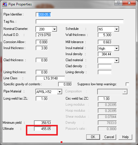

Given the following example information:
Sc = 0.33 Su T at minimum installed or operating temperature  = 0.33 * 455.05 = 150.16 N/mm2
Sh = 0.33 Su T at maximum installed or operating temperature  = 0.33 * 455.05= 150.16 N/mm2

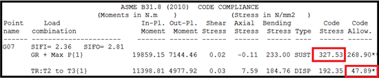

SL = 327.53 N/mm2
f = Range factor = 1.0 (setting from Tool> model Options> Results)
Sa = 1.0 * [ 1.25 * (150.16 + 150.16) - 327.53]
Sa =  47.886 N/mm2 as shown in the output report above.
