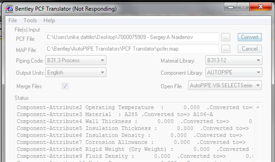

Q. When running the PCF translator the following occurs:
Bentley PCF Translator (Not Responding)
What should I do?
Answer.
When using the PCF translator, select the file to be converted, make additional changes to all the other settings as needed and press the Convert button.
After pressing the Convert Button, suggest that you remove your hands from the keyboard and mouse. The translator is using a significant amount of system resources to convert the file. Some files that are converted have over 100,000 lines in one file. By pressing a button on the keyboard or mousing over something system resources are taken away from translator. Sometimes when this happens the application will show the Not Responding message and become grayed out, as seen above.  However the software is still trying to recover and complete the conversion process. Again, do not touch anything. Most of the time the application will complete the conversion, the PCF  translator will no longer show the Not Responding message and you will be able to open the newly converted file in AutoPIPE.
No mater the size of the model, be patient and let the application complete the conversion before moving onto another task. Again, this application is sensitive to system resource allocation. Regardless, if the model is converted and can be opened by AutoPIPE, everything should be ok, continue working on your analysis in AutoPIPE.
If this issue occurs a lot, you may consider adding more Ram or a better CPU. Also, if after an extreme amount of time, the Not responding message is still visible, close the application, file a service request, and send Bentley the PCF file you are having troubles with for review.

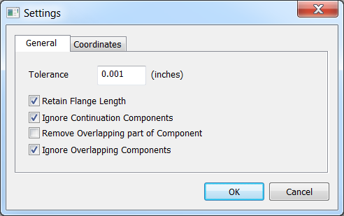

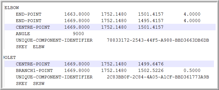

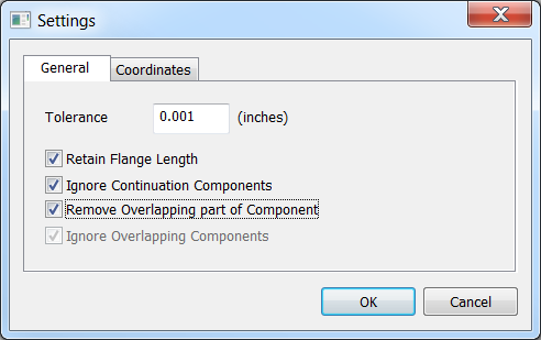

After reviewing this model in detail, noticed that the PCF file contains an ELBOW and OLET. OLET center point is overlapping bend center point by 2 inches as highlighted below.
On Settings dialog when Remove overlapping part of Component checkbox is checked then program connect the OLET center point to ELBOW center point which causes the hang issue.
When Remove overlapping part of Component is unchecked and Ignore Overlapping Components is checked as shown below, then the OLET will be ignored during PCF import and program will not hang.
