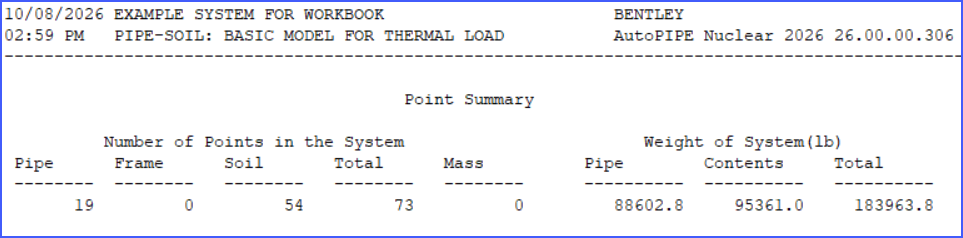

#1: Points Summary report
As mentioned above, one of the best tools for understanding the node points distribution in a model is the  "Points Summary" report. This will help you understand the type of node point accounting for the majority of the node point count.
As can be seen in the image above, soil points are usually the major contributor that most users overlook. These soil points can be viewed in AutoPIPE by using the Soil Points (Show > Labels > Soil Points) command. In addition,
