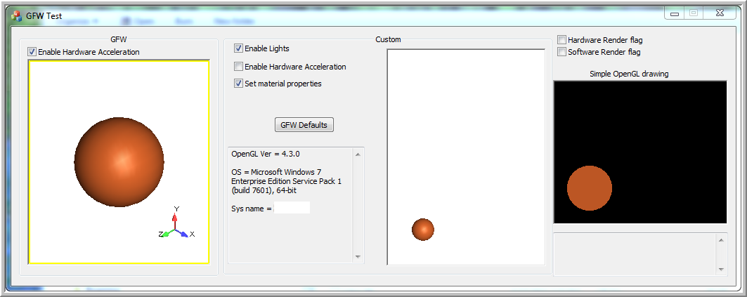

Now for the test, perform the following test to determine if your computer graphics card is able to run AutoPIPE:
1. Download file based on version of AutoPIPE in use
AutoPIPE CONNECT 11.00.xx.xx and higher
AutoPIPE V8i 09.06.xx.xx and lower
2. Unzip contents into the AutoPIPE program folder, (may need IT help with permissions)
Example:
C:\Program Files (x86)\Bentley\AutoPIPE CONNECT
C:\Bentley\AutoPIPE V8i SELECTseries\
3. After moving the application into the path mentioned above, double click on GFWTest.exe to run.
4. Once the application is opened, the program will be drawing a sphere using 3 different methods for OpenGL (OpenGL 1.2, GL Utility Library, and GL Auxiliary Library). We want to see if something goes wrong.
Typical results should look like the following:
Question: Does your graphics test look like that above?
If yes, my results are similar to the screen shot above, therefore your computer should be able to run AutoPIPE without graphic related issues on normal sized models.
If no, my results are not similar to the screen shot above, then take a screen shot of the GFWTest window, submit a service request for TSG support, attach the screen shot of the test in a ZIP file to the SR, and send for review.
