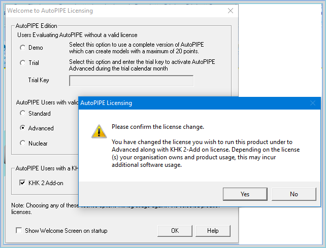

"Please confirm License Change"...message appears while using AutoPIPE, why?
Product(s):AutoPIPE
Version(s):CONNECT and higher
Area: Licensing
Date Logged
& Current Version
May. 2017
11.00.00.22
The following message similar to the one below appears when changing the License configuration in a CONNECTed version of the application:
AutoPIPE Licensing
Please confirm the license change.
You have changed the license you wish to run this product under to Advanced along with KHK 2-Add on license. Depending on the license (s) your organisation owns and product usage, this may incur additional software usage.
Yes No
 Why and what does it mean?
As the message displayed states "Depending on the license (s) your organization owns and product usage, this may incur additional software usage". This is a clear warning to the user that you may incur additional charges if your contract does not contain this particular license based on the License configuration settings just selected.
