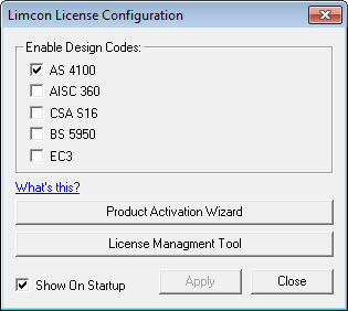

To configure and activate a Limcon license, go to License Configuration under the File menu within Limcon. Note that this dialog will appear automatically after the first launch of Limcon following installation.
Select the desired design codes in the Enable Design Codes section. Selecting Apply at the bottom of the dialog will enable only the codes that have been selected. Note that at this point the product is not activated, but the design codes chosen will be communicated to SELECT server once activation takes place.

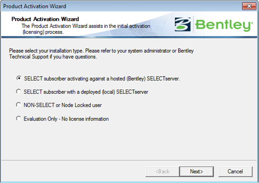

To activate the product, select Product Activation Wizard at the bottom of the dialog. The ensuing screen will list four activation options. To determine which option is appropriate, consult the systems administrator at your organization or contact Bentley technical support. Generally speaking, users new to Bentley will, in most cases, be activating against a hosted SELECTserver.
Detailed instructions for completing the product activation, dependent on which activation method is utilized, are available at the following links:
Activating against a hosted (Bentley) SELECTserver:
https://bentleysystems.service-now.com/community?id=kb_article_view&sysparm_article=KB0019263
Activating against a deployed (local) SELECTserver:
https://bentleysystems.service-now.com/community?id=kb_article_view&sysparm_article=KB0019772
Activating as a NON-SELECT or Node Locked User:
https://bentleysystems.service-now.com/community?id=kb_article_view&sysparm_article=KB0019082

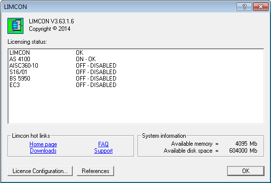

As with past versions of Limcon, the features that have been activated and are available to the user can be reviewed in the Help -> About dialog, as shown below.
