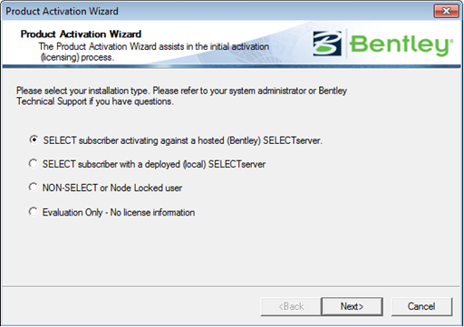

To activate the product, select Product Activation Wizard at the bottom of the dialog. The ensuing screen will list four activation options. To determine which option is appropriate, consult the systems administrator at your organization or contact Bentley technical support. Generally speaking, users new to Bentley will, in most cases, be activating against a hosted SELECTserver.

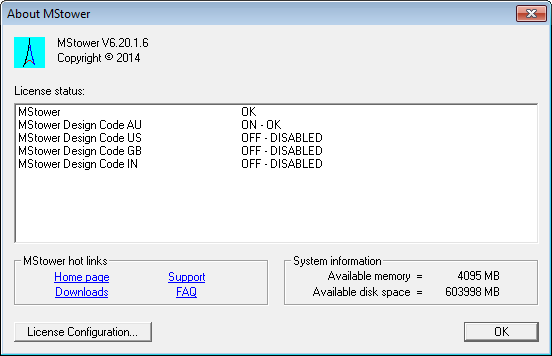

As with past versions of MStower, the features that have been activated and are available to the user can be reviewed in the Help -> About dialog, as shown below.
