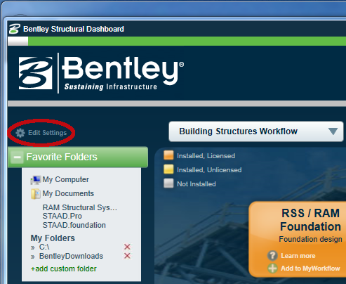

Option 1 - Turn off the auto-start feature from within Structural Dashboard
  1. Open the Structural Dashboard by either opening a Structural Product or by selecting from the Windows Start menu:
    All Programs -> Bentley Engineering -> Structural Dashboard V8i SELECTseries 1
  2. Click the Edit Settings button in the upper left corner.

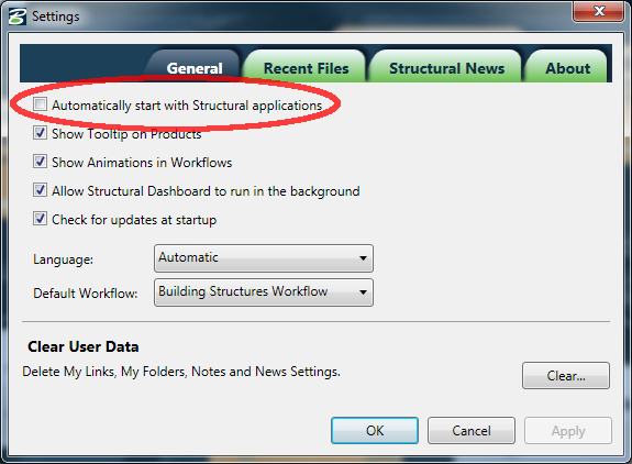

  3. Remove the checkmark in the first checkbox.

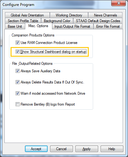

Option 3 - Change settings within each program
In some individual applications, like STAAD.pro SELECTseries 5, there is an option within the program configuration to control whether the Dashboard shows on startup or not.
