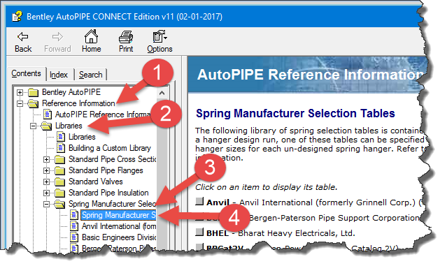

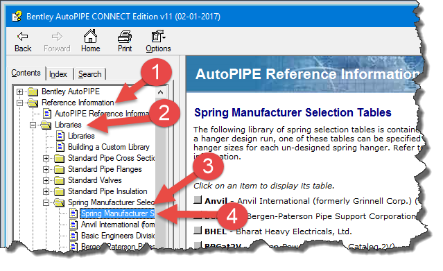

View Spring data:
There is no active command to review Spring data similar to reviewing Material data. Instead all spring data is displayed in AutoPIPE help for review. see help section shown below for details.

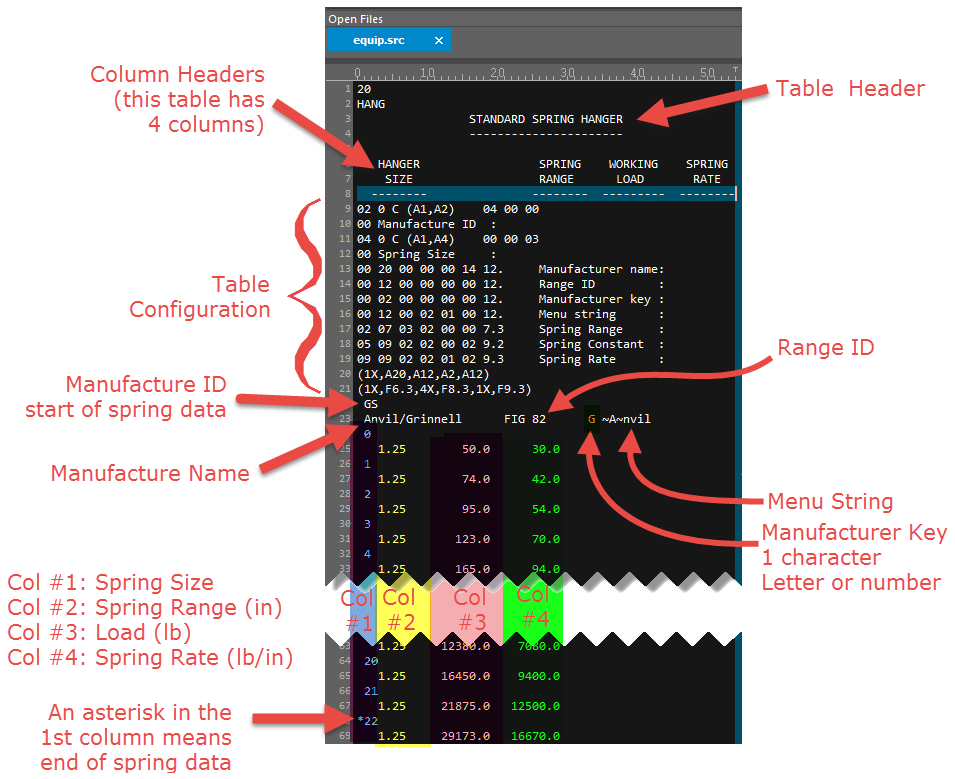

5. Each spring has a start point and end point for the respective data. The start point always coincides with the Manufacture ID row and ends at the next row that starts with an asterisk. For example, using Anvil/Grinnell imaged above, spring data starts on line 22 with Spring ID = GS and ends on Line 63 where there was an "*" shown in column #1.

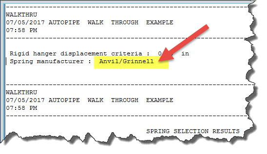

Line #1:
Manufacture ID:
Starts in column #2 of the row text, Column Width = 2, Units = None
Starting point for an individual spring, only has 2 characters (1st character always matches Manufacture Key on line #2, and 2nd character can be one of the following: S,M,L,X,Y, or Z in order).
Line #2:

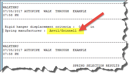

Manufacture Name:
Starts in column #2 of the row text, Column Width = 20, Units = None
Contains Manufacture name to be displayed on output report.

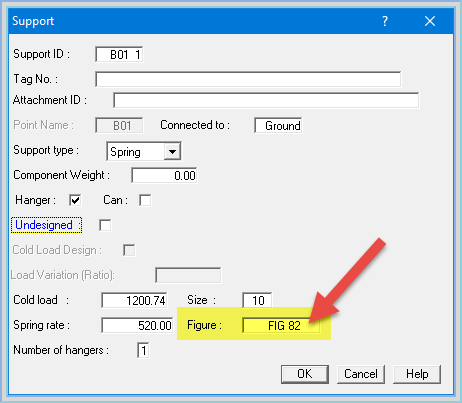

Range Id:
Starts in column #21 of the row text, Column Width = 12, Units = None
Represents a spring's identification to the manufacture that will be displayed in the Figure field on a Support dialog screen.
Manufacture Key:
Starts in column #34 of the row text, Column Width = 2, Units = None
Must be a unique value that does not match any other keys in the spring table. Can be letters or numbers.

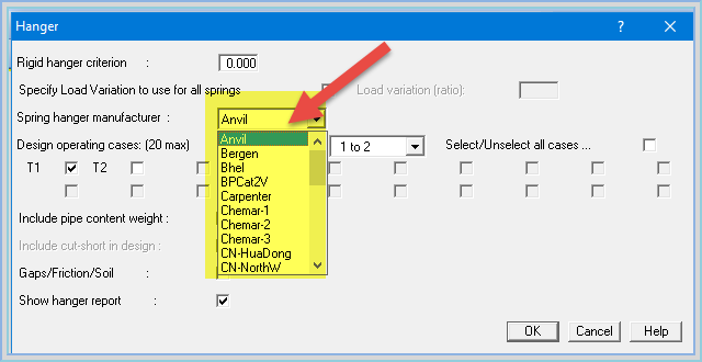

Menu String
Starts in column #36 of the row text, Column Width = 12, Units = None
String shown when selecting a Spring manufacture from the drop down listing of a Hanger Analysis command
Line #3:
Spring Size
Starts in column #2 of the row text, Column Width = 4, Units = None
Line #4...#n
Spring Range
Starts in column #3 of the row text, Column Width = 5, Units = inch (dimension)
Spring Constant
Starts in column #8 of the row text, Column Width = 12, Units = lbf (force)
Spring Rate
Starts in column #20 of the row text, Column Width = 10, Units = lb/in (translational)

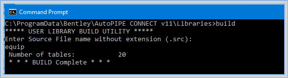

6. Again, AutoPIPE stores all flange materials, gasket data, nozzle loadings, spring data, etc in a single file called Equip.LIB. This LIB file is compiled from an *.SRC file using the build.exe utility in the AutoPIPE/Library folder (see help for details on compiling a file).
Save original Equip.SRC file to a safe location, save new library to Equip.SRC, compile library from SRC file to LIB.
If everything was done correctly after compiling the library the following should have been displayed:
If anything else besides ***build complete*** displayed as imaged above, then there is an error in the library (ex. extra space, wrong format, column alignment, file name, bad character, tab key was used, etc...) Cannot continue. The file must compile as imaged above. Word of advice, anything out of place will cause the file to not compile correctly, sometimes starting over with a fresh clean library is required, make a small number of changes or add a single new spring table to be sure the library compiles without any issues.
