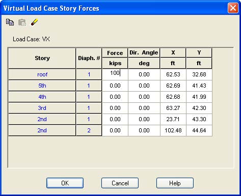

Defining Virtual Load Cases
To define the virtual load cases for analyzing roof drift:
This returns you to the Load Cases dialog box.
Next, you need to analyze the new virtual load cases:

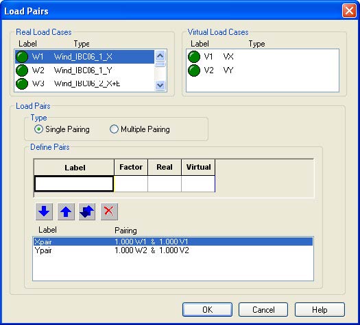

Defining Load Pairs
In Order to pair the virtual loads with real load cases and perform the Drift Control Analysis, you must now enter the Drift Control Mode of RAM Frame:
In the center portion of the box under Define Pairs:
This takes you back to the graphics screen. To analyze the load pairs:

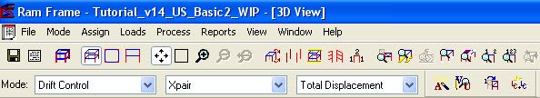

The screen should now display a color coded image of the structure. Members shown in warm colors (i.e. red, orange, yellow…) are participating more in the resistance of the roof drift based on the current load pair (X Pair) and the current evaluation method (Total Displacement). In this case, you can see the beams of the north moment frame do the most work, indicated by their color.

Another way of reporting participation is to divide a member’s participation by its own volume. In this way you can see where increasing a member provides the most benefit.
To review the results as Total Displacement/Volume:
A dramatic change should occur in the screen output. The walls that were red or yellow are now blue. This happens because while that member does a lot to resist drift in the Y direction (even at the roof), it is also has a much larger volume than the steel members. Now the lower level braces the frames should be the highest participating members by volume.
