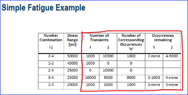

As known, this is the from the training material for fatigue analysis. It is completely fictitious and made up by the training author. The information is all there in the two previous slides. No additional information is available.
"Fatigue" - AutoPIPE load case
