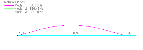

Case 2a - One Intermediate Node - Lumped Mass
In Case 2a (lumped mass), there is one intermediate node and it is assumed to have half the mass of the beam with the support nodes having one quarter each. The first transverse mode is found with an error of -1%, but the second transverse mode is not found at all. The second mode is the axial mode (error -3%) and the third mode found is actually the second axial mode.
Lumped Mass
Case 2b - One Intermediate Node - Consistent Mass
Case 2b, with one intermediate node and consistent mass determines the first three modes with errors of 0.4%, 11%, and 2.5%, respectively.
Consistent Mass
