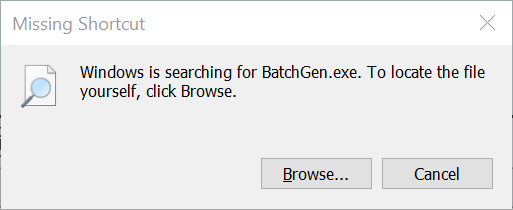

How to fix the Start menu shortcut for any AutoPIPE application using Win 10?
 Manually open this folder location here.
C:\ProgramData\Microsoft\Windows\Start Menu\Programs\Bentley Engineering
Locate the correct application in the subfolder (example: \AutoPIPE CONNECT v12\ AutoPIPE Batch Generator)
Hover the mouse overtop the application name and use the Right mouse click button to expose the menu, and select Properties at the bottom.
Update the "Target" path" or "Start In" path as needed
Example update
1. Target path
from: "C:\Program Files (x86)\Bentley\AutoPIPE CONNECT v12\BatchGen.exe"
to : "C:\Program Files (x86)\Bentley\AutoPIPE CONNECT v12\BatchGenerator\BatchGen.exe""
2. Start In path
from: "C:\Program Files (x86)\Bentley\AutoPIPE CONNECT v12\"
to : "C:\Program Files (x86)\Bentley\AutoPIPE CONNECT v12\BatchGenerator"
