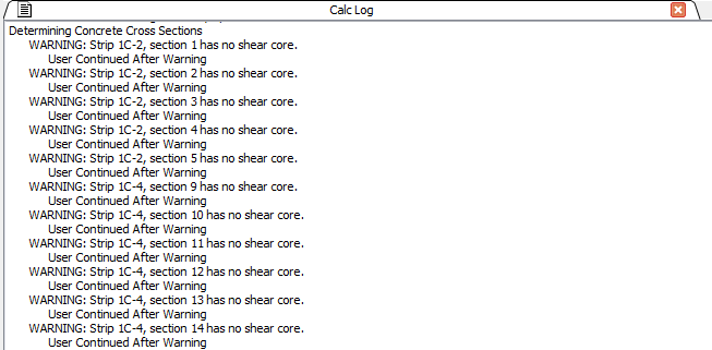

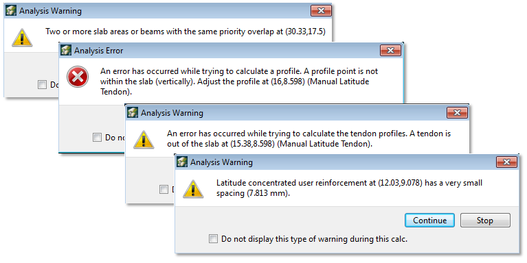

As in previous versions of RAM Concept, during the calculation process a message is shown on screen each time an error or warning is encountered. The user has the option to review or dismiss each message, or even stop the CalcAll process altogether. In previous versions of the program, once the CalcAll process was complete, the user needed to open the log file to revisit any of the messages that were delivered. This log is simply a text file and thus locating specific types of messages needed to be done using a word search. In order to pinpoint the plan location of a specific error/warning, the user had to use the coordinates associated with the error/warning to manually find the location on the relevant plan.
Figure 3 - RAM Concept Calc Log showing error and warning messages resulting from the most recent calculation.

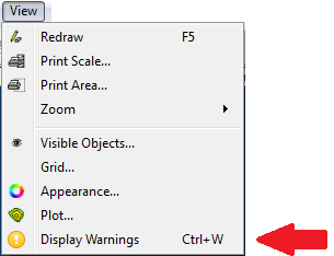

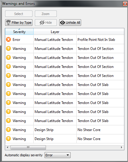

RAM Concept CONNECT Edition offers a new graphic interface to facilitate the error finding process. This is accessed with the Display Warnings command under the View menu or the toolbar. All warnings and messages are listed in an interactive dialog, with the ability to sort and filter the messages by type: Failure, Error, Warning, or Performance (see Figure 2).
Figure 4 – Display Warnings command within the View menu.

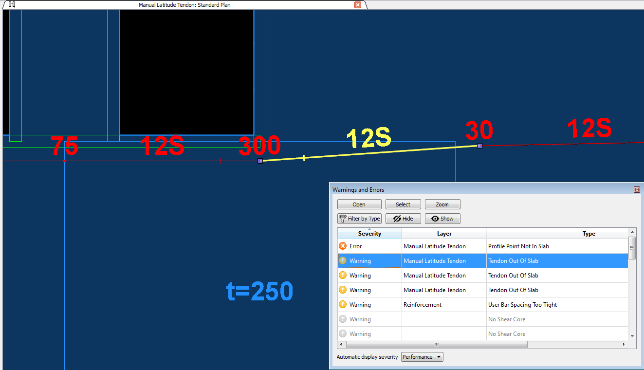

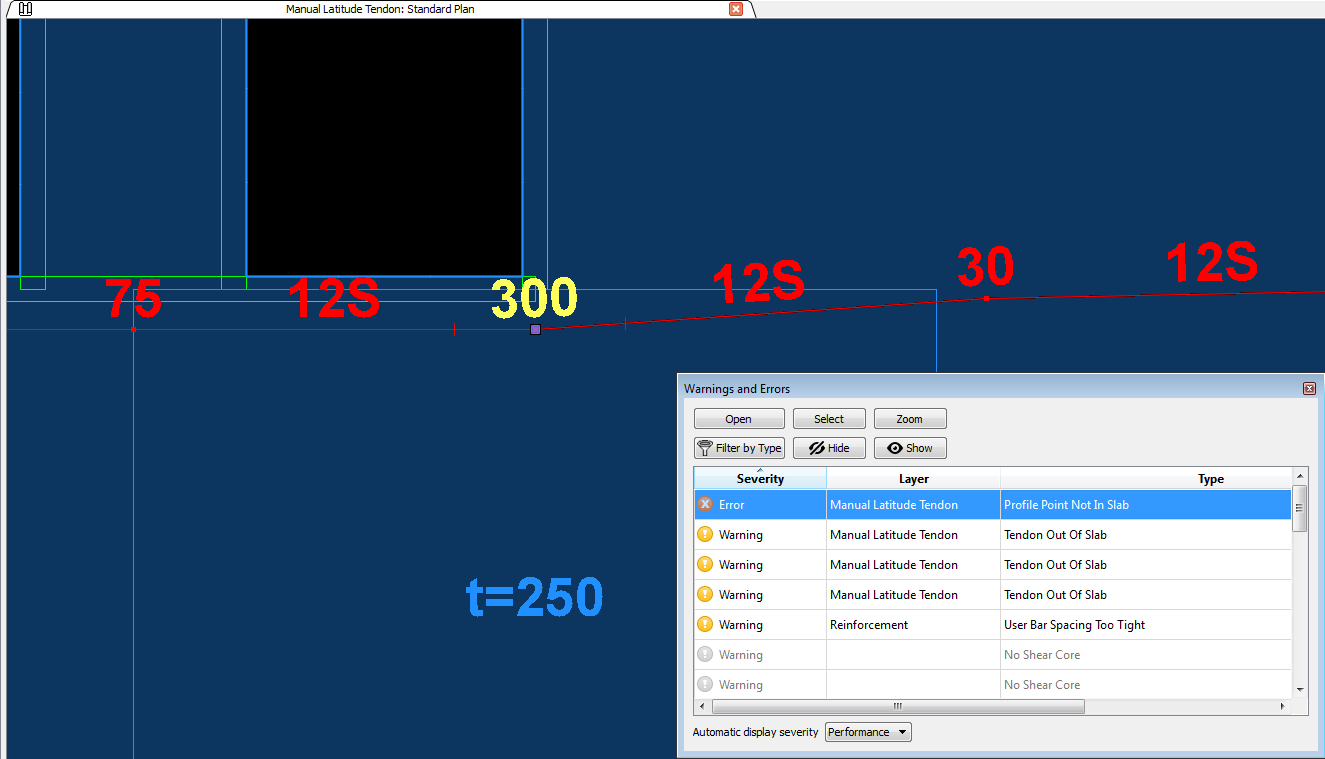

With a specific row selected in the Warnings and Errors dialog, clicking Open (or double clicking) will bring up the plan on which the error can be resolved. For example, for the Error listed in Figure 7, clicking Open will open the Manual Latitude Tendon plan, on which the elevations of the tendon can be adjusted to resolve the error. Further, the relevant object is highlighted on the plan. In some cases this will be an object that users can edit directly. Examples of this include a tendon or a reinforcing object. In other cases, this object will take the form of a marker drawn only to visually clarify the error/warning. Examples of this include a distinct point on a plan, or a segment denoting something such as a design section.
Selecting Zoom will zoom in on the location of the error/warning on the plan.
Figure 7 –‘Latitude tendon profile error’ selected, with the tendon high point that is in error highlighted
Figure 8 – ‘Latitude tendon out of slab’ warning selected, with the tendon that is in error highlighted
