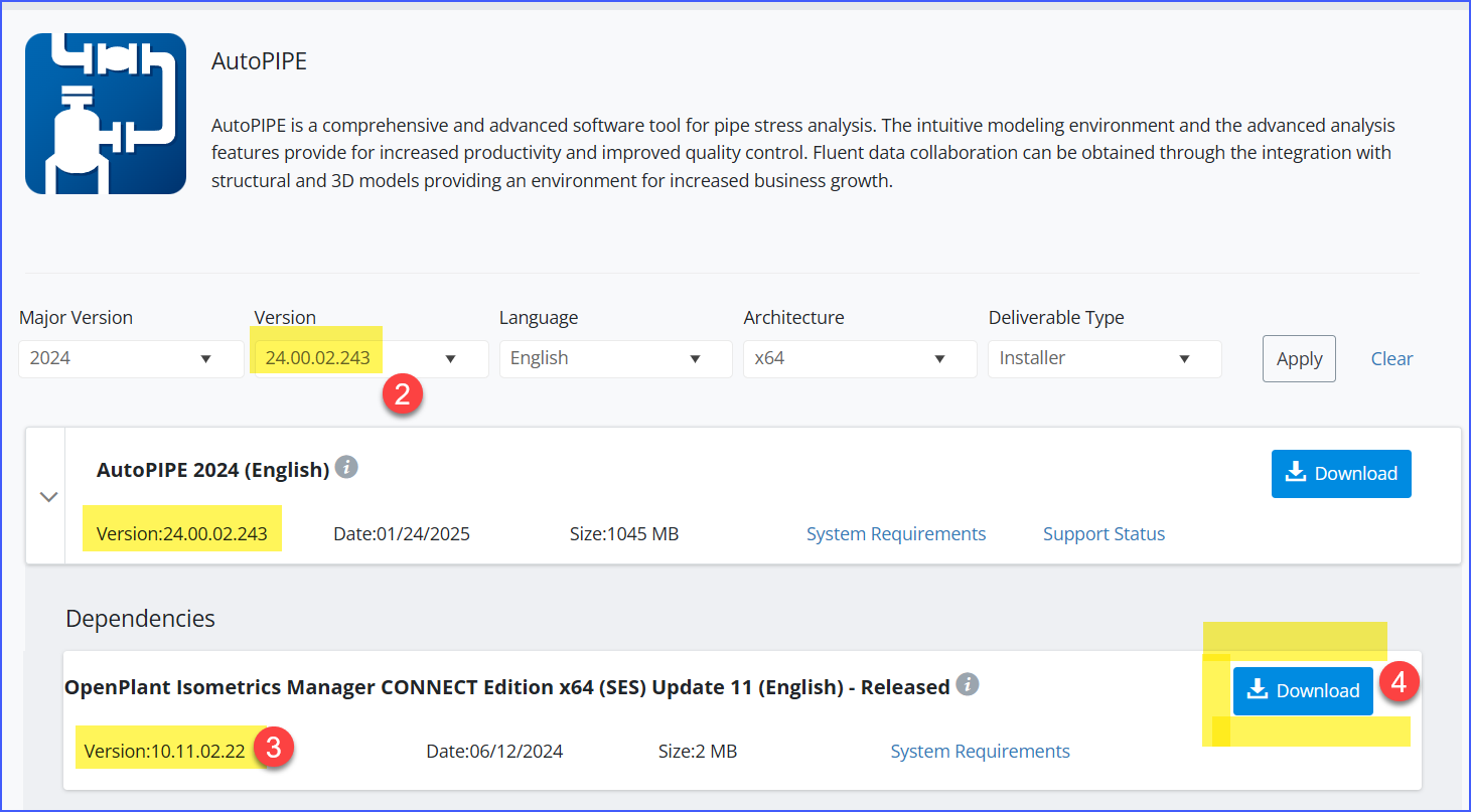

Option #1:
1. See instructions here to access the Software Download page and navigate to AutoPIPE software.
2. Filter software to version of AutoPIPE installed (ex. 24.00.02.243)
3. See list of "Dependency", for version of OPIM (ex. 10.11.02.22)  to be used with a specific version of AutoPIPE
4. Press the download button to download the software.
5. Once downloaded, install the application.

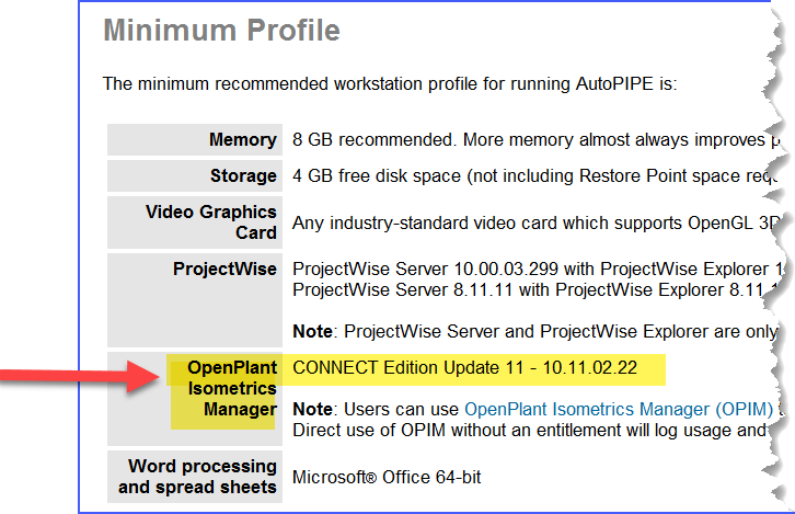

Option #2:

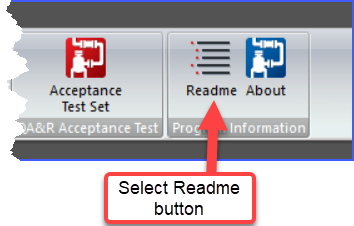

1, Start AutoPIPE
2, Select Help ribbon, and choose the Readme button.
3. Go to the "Requirements" section
4. Under the Minimum Profile, find version of OPIM (ex. 10.11.02.22) that should be used with the respective AutoPIPE version (ex. 24.00.02.243).

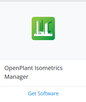

7. Set Brand = OpenPlant and press Apply button

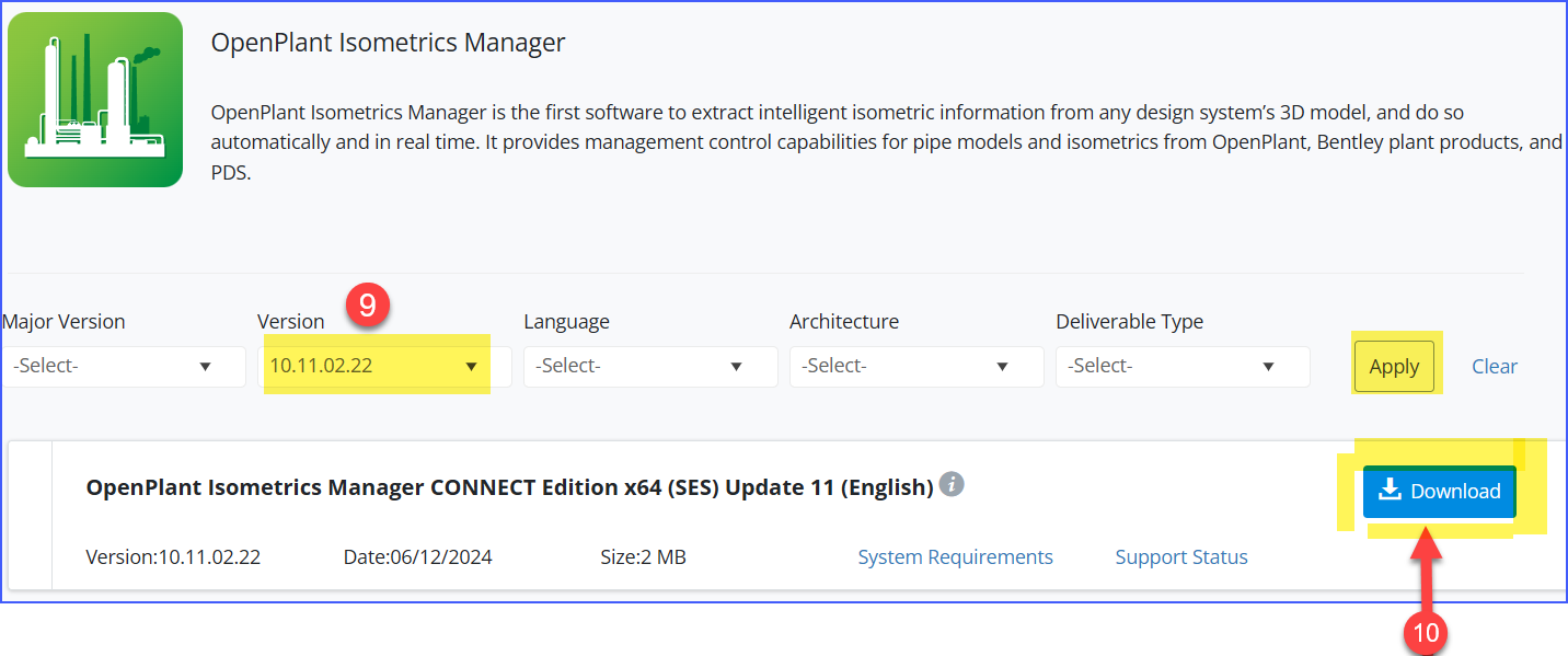

8. Select the "OpenPlant Isometrics Manager" button.
9. Press the Clear button and filter for version indicated above (example 10.11.02.22), press Apply button again to clearly filter the listing..
10. Finally, press the Download button to download the software and install.
