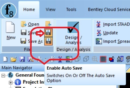

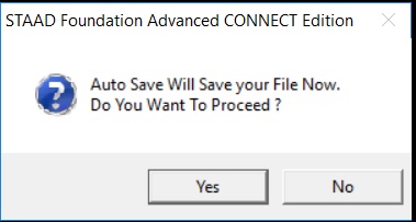

How do I stop the Auto Save dialog box popping up while I'm working on a model?
In the Home page, there is an option to turn the Auto save off as shown here. By default, this is on; clicking on it turns it off.
