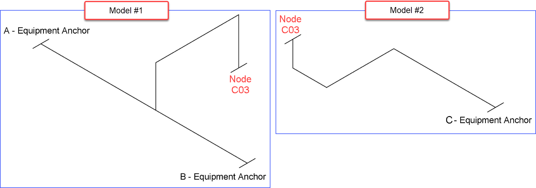

How to model node point shared by more than 1 model?
Another words, how to transfer Forces and Moments at 1 node point that is shared between models?
Example:  Node point C03 is shared between Model #1 and Model #2
What needs to be done at the shared node point (ex. C03) in each model so analyze results of individual models matches that of a total combined model 1&2.
Instead of modeling to a run Node point (ex. C03) shared by both models, suggest to model pipping to an anchor location shared in both models, and provide both model results to the structural people to correctly design the anchor.
Recommend to not use a typical piping run point, flange junction, branch connection, valve, etc.. as shared point between 2 models. One cannot just take the forces and moments results from a model, insert them into the next model, and assume that analysis results would be correct.
