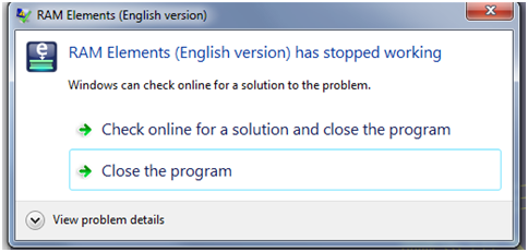

On some machines, the error message below is produced followed by a program crash during the design process. Other times the error occurs simply starting the program.
Install version 13.04.01.208. If the problem persists please notify Bentley Technical Support through the Forum or Service Request and then try the methods below.

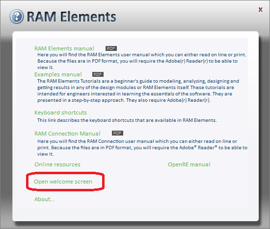

1) Disabling the Welcome Screen manually to prevent the crash from occurring.

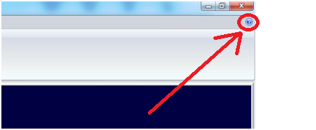

The Welcome Screen identified below appears when the program is launched. After launching the program, the Welcome Screen can be opened by clicking on the Help button in the upper right corner of program window (see screen captures below):
In the Welcome Screen, uncheck the box to the left of Welcome Screen in the lower left corner to disable it.
After disabling the Welcome Screen, you will no longer see news information on program updates and other important items when opening the program. The Welcome Screen can be opened anytime by clicking on the link in the Help menu. The news information can also be found on the following web page:
http://feeds.rapidfeeds.com/8826/

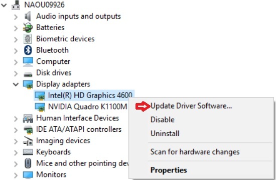

3) In some cases, updating video drivers resolves the issue.
In Windows 7, follow the steps :
In Windows 8 and 10, Go to the Control Panel\Hardware and Sound -> Select Device Manager -> Display Adapters -> You should see couple of devices; Right click on each of them and select 'Update driver software'.
Once done, reboot the system.

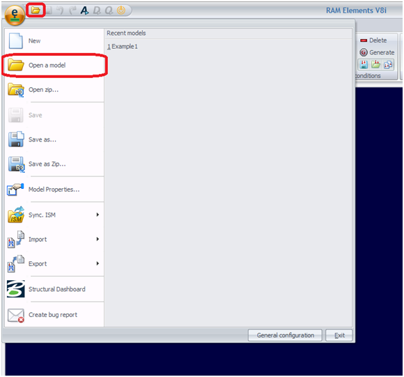

A similar crash occurred in versions of RAM Elements prior to v13.03.00.117. In earlier versions, the crash also occurred when a model was opened by one of the following methods:
In earlier versions, the crash was avoided by opening the program within the program as noted below:
