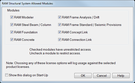

In RAM Manager, the Tools – Manage License Restrictions command opens the following dialog:
This provides a mechanism for the user to prevent a module from being inadvertently executed. When the program is first installed all of these options are selected. It is important therefore to execute this command and deselect any modules or links for which the user wants to restrict access.
To prevent a module or program link from being executed, deselect that item.
If a module is deselected here and that module or link is subsequently invoked, the following dialog appears:
If Allow is selected the module will open, and usage will be logged. If Cancel is selected the module will not open and no usage will be logged. Settings opens the previous command, allowing the user to modify the selections of the allowed modules.
