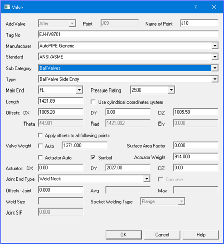

Valve is not listed in valve catalog, how should the missing valve be modeled in AutoPIPE?
Note that in pipe stress analysis all that matters is the length of the valve, weight of the valve with /without actuator, surface factor, and end connections. Sometimes the library will have your particular valve, other times the specific valve is missing.
When the valve is missing you have 2 options,
1. Update the Component library to include the valve. This take a little effort and can be cumbersome. Note that you cannot add a valve spec.
2. Use Manufacture = AutoPIPE generic, and fill in the remaining information as needed.
Most of the time, suggest using option #2.
