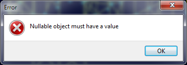

Problem: Error "Nullable object must have a value" during design
During the AISC 360-10 Steel design process using release 13.03.00.99 (or 13.03.00.101) an error message can occur indicating:
The error stops the design process.
Use version 13.04.00.177 or later, otherwise use the 2005 edition of the code.
Using other section types can also solve the problem, depending what shapes are needed.
