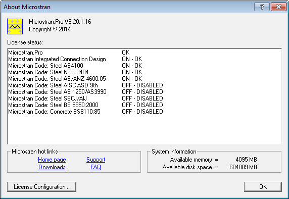

As with earlier versions of Microstran, the tier and associated features that have been activated and are available to the user can be reviewed within the Help -> About dialog within Microstran, as shown below.
