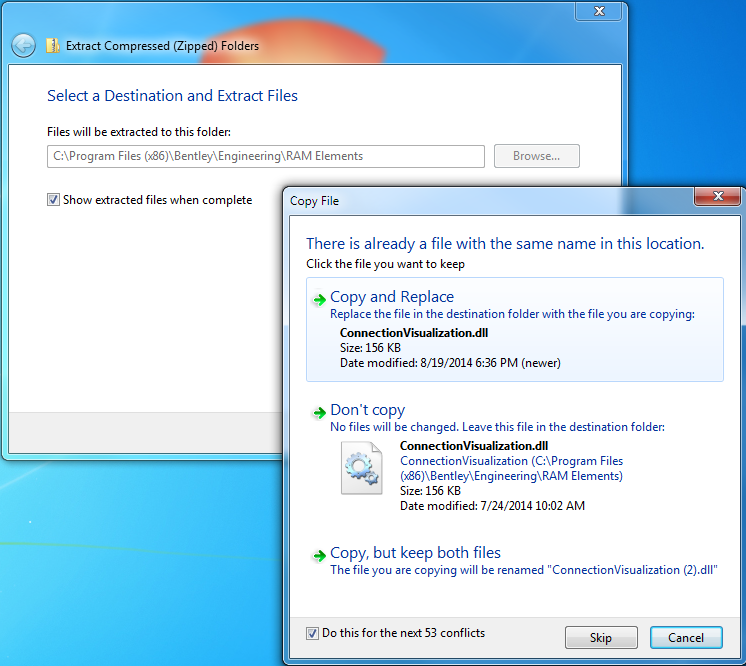

4. Extract the files using to the following directories,

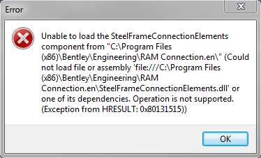

IMPORTANT - use only 7-zip to extract these files, not Windows or WinZip. When using 7-zip, make sure the program is run as an administrator. You can do this by right-clicking on the 7-zip shortcut, choosing Properties from the menu, clicking on the Compatibility tab, and checking the appropriate box. If 7-zip is not an option, then contact support with a service request. Otherwise the extracted files may have an altered time stamp and the upgrade will fail, giving an error like this:
Details about this unzipping time stamp problem here

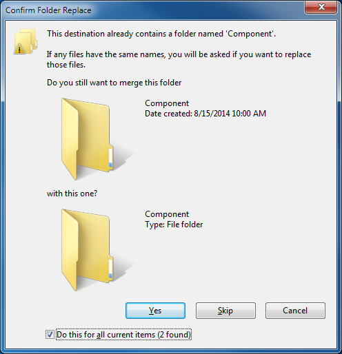

Overwrite existing copies in all cases:
Also merge the contents of any subfolders:

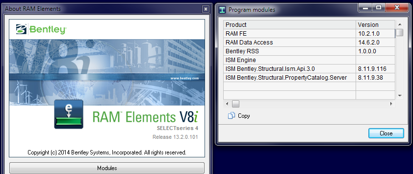

5. Confirm success by checking Ram Elements - Help (?) - About.
