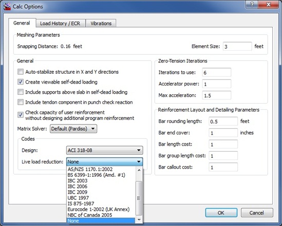

- Note, in Ram Concept, in order for Live Load reduction to occur the loads need to be of a reducible type and the Ram Concept - Criteria - Calc option setting for Live Load Reduction Code must be set (see below). Reducible live loads on Mat Foundations are the exception to this rule. Those loads come into Ram Concept already reduced. Reducible transfer loads for elevated slabs that are imported into RAM Concept are not reduced.

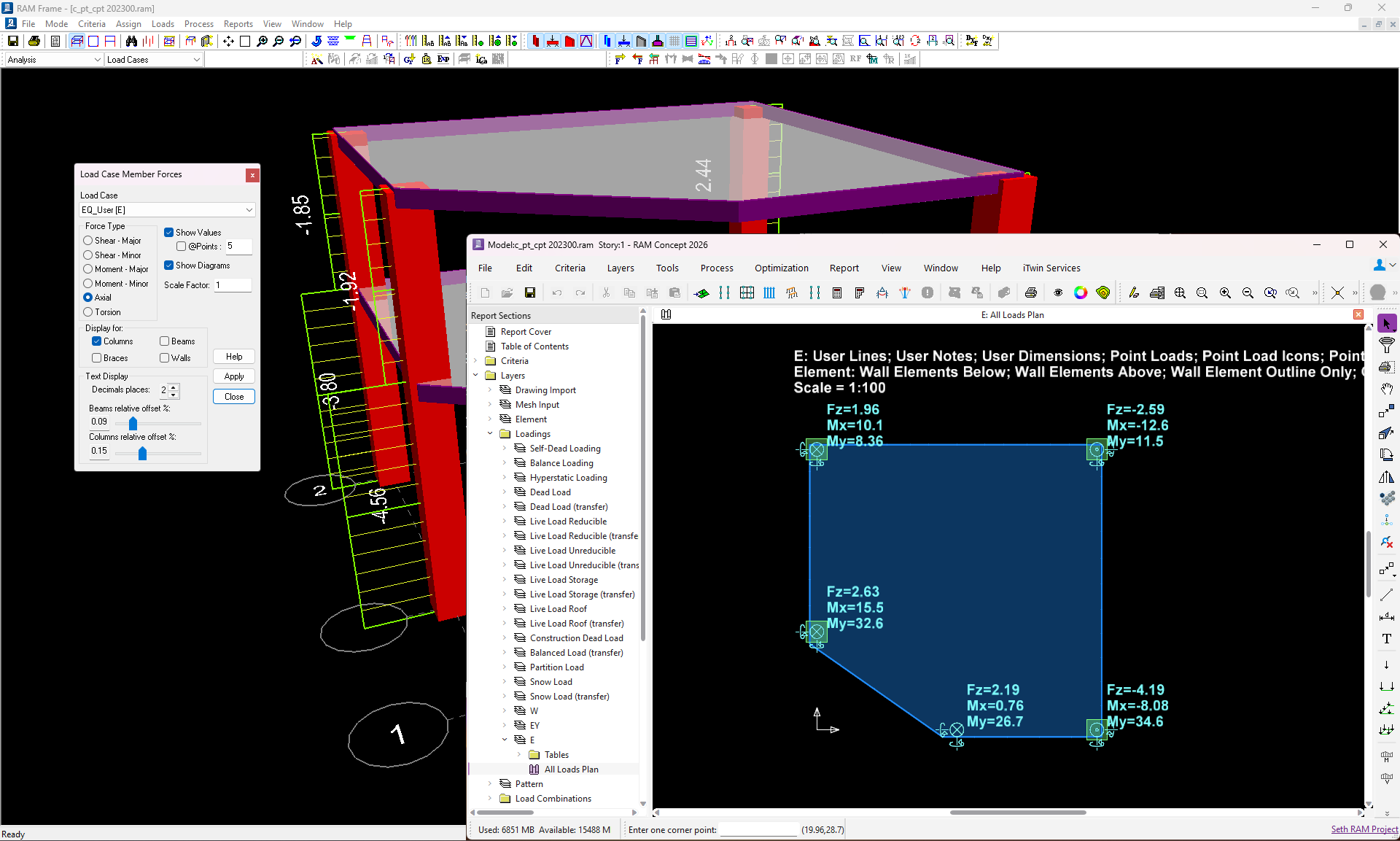

- Wind and Seismic Load are imported as point loads at walls and columns as part of a Lateral Self Equilibrium load case (see Figure 1) . Please see RAM Concept Lateral Self Equilibrium for more information.
Figure 1. Imported Lateral Self Equilibrium Load Case.
- In RAM Structural System v14.06.00 and earlier, all wind loads are imported as service type loadings and all load combinations are generated assuming this loading type. In RAM Structural System, wind loads that are generated using ASCE7-10 are ultimate loads, however. In models with ASCE7-10 wind loads, the loading type should be changed to ultimate loads after importing into RAM Concept (Criteria - Loadings) and, then, the load combinations should be rebuilt (Criteria - Rebuild Load Combos).
