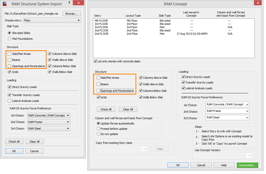

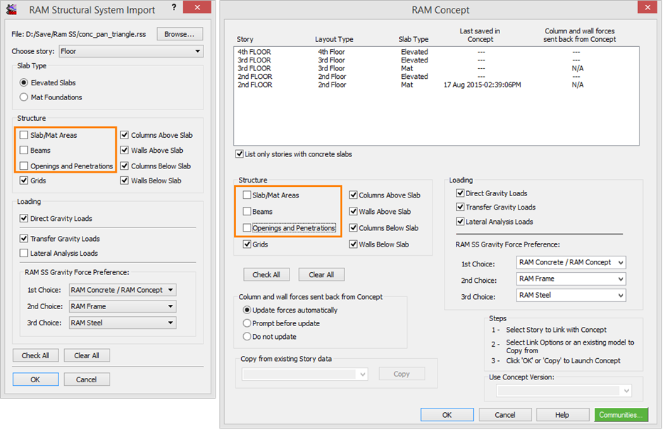

Important - if you are making changes to the slab, drop caps beams or openings in Ram Concept Mesh Input - Standard Plan, then it's important not to update those objects when Syncing to the RAM SS model later. Simply uncheck those items from the File - Sync Ram - Update from RAM Structural System... dialog box, or similarly uncheck those items from Ram manager - Design - Ram Concept as indicated below.

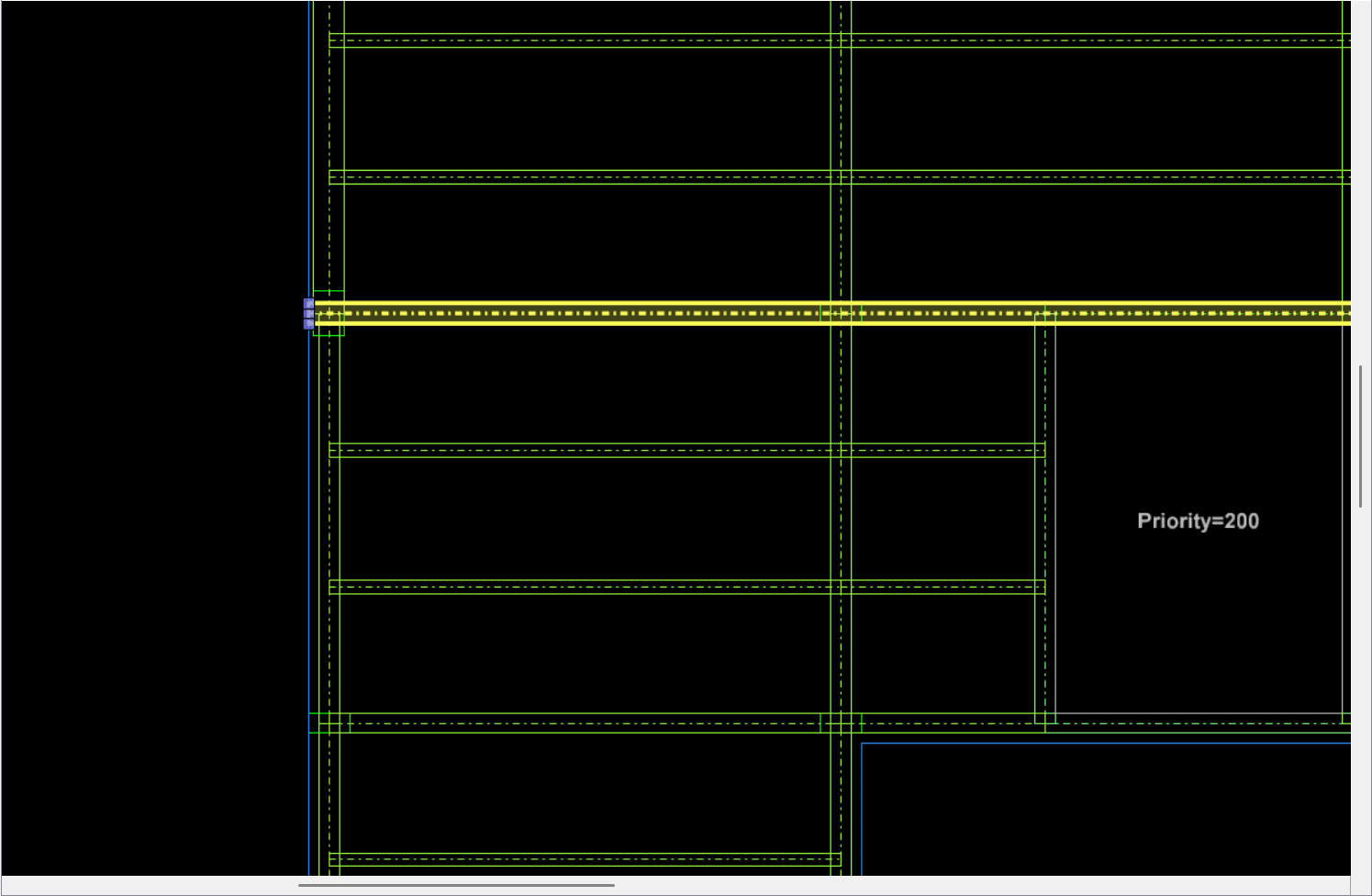

Beams in RAM Concept are meshed with the slab. For continuous beams modeled in RAM Concept, it is not necessary to model the beams in segments from column to column. Meshing problems are often prevented by modeling continuous beams as one beam segment from outside face of the first column to the outside face of the last column bypassing each intermediate column. Beams modeled in RAM Structural System are modeled support to support. When the beams are imported into RAM Concept, they are brought into the program as segmented members between each support. In most cases, there will be multiple overlapping areas at the column (see Figure1 below). Since this can produce meshing errors in some cases, it is often easier to not import beams and then create them in RAM Concept after the model is imported and modeling as a continuous beam (see Figure 2 below).
 Figure 1. Beams Segmented at Column After Importing.
 Figure 2. Model Beams as Continuous Beams in RAM Concept.
