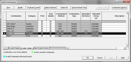

"Code Comb" tab Questions
The "Code Compliance" grid displays the combination set defined for piping code compliance (both the default combinations and user-defined sets). Any default code combination may be modified, deleted or reset and any new user combination created and modified in the same grid.

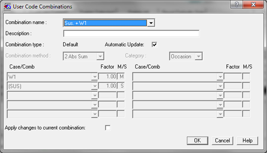

User Code Combinations dialog
