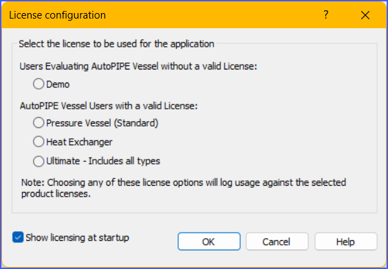

If everything was correctly installed and licensed the following should be displayed, select a valid license option per the available license(s) in BLT and press OK button to use the program:
Notes:
a. Suggest to leave "Show Licensing at startup" enabled to confirm license selecting when starting the program).

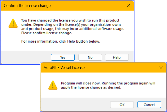

b. At any time, if the user selects a license, the following warning will be displayed:
The user has the option to accept or reject the License. If pressing "Yes" and the License was not on the account, this action will be marked as over using your signed contracted amount that was agreed upon with Bentley. Instead of paying for another full License to a program, users are only charged for the time using licenses not on their contract. For many accounts this has saved them a lot of time and money.

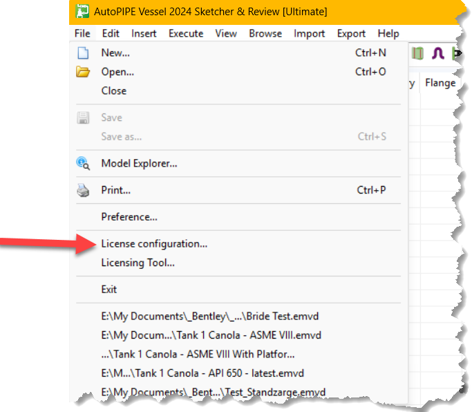

c. To review AutoPIPE Vessel License settings, select File> License configuration...

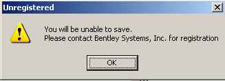

2. The following is displayed:
Answer: The program is in Demo Mode, correctly license the application. From within AutoPIPE Vessel select File> License Settings> choose a radio button that allows the use of the function trying to analyze under.

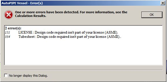

3. The following is displayed when running application:
Answer: The problem is that you do not have the correct license available to use this feature of the program.
