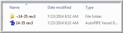

2. Folder Was not Deleted:
When a model is opened in AutoPIPE Vessel, a Folder with the same name as the model but starting with "~" is created in the same location as the model. Example: see image below:
When the model is closed by the program, this newly created folder is deleted, or should be deleted. However, sometimes the folder is not deleted. The next time when the file is opened in the program some application functions will not be available (i.e. Execute> Strength Calculation).
To fix, close AutoPIPE Vessel and remove / Delete the "~systemname" folders and restart the application, re-open the model, and try to run the Strength Calculation command again.
