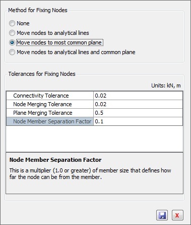

Refer to Appendix A for details on settings in this dialog.

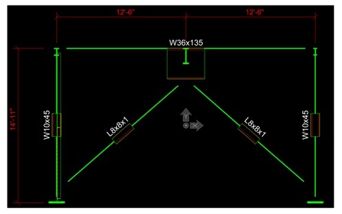

ProStructures allows the user to choose the insertion point for steel (and concrete) beams and columns, as well as steel horizontal braces, vertical braces, stair stringers, etc. Some other structural software programs refer to this as the “cardinal point” or “placement point”.  In ProStructures, the insertion point defines the ‘member line’ of the object.
ProStructures insertion points
ProStructures is designed to allow fast and accurate structural modeling and there are behaviors built-in to the program to take advantage of the insertion points.  In a typical structure, columns may be placed using an insertion point of center-center (CP=5).  Beams are typically placed with an insertion point of top, center (CP=8).  Vertical braces may be placed according to Bottom-Left or Centroid (CP=1 or CP=10).
This approach to physical modeling allows for extremely fast and accurate modeling of steel and concrete frames.  Moreover, the resulting model is set-up very well for all types of drawing production, especially where steel elevation drawings are produced in single-line mode as shown below.  Please note that the W36x135 beam ‘member line’ appears at the top of the columns (because the beam was modeled with an insertion point of top-center).  Also note that the columns are dimensioned to their centerlines (because the columns were modeled by an insertion point of center-center).
Elevation drawing using single-line display with widgets (the term used to describe the short portion of the shape).

For this type of modeling, the following settings are recommended:
Include Member Offsets
False
Method for Fixing Nodes
Move nodes to analytical line and common plane
Connectivity Tolerance
Small number such as 1mm
Node Merging Tolerance
Small number such as 25mm
Plane Merging Tolerance
Node Member Separation Factor
0.1

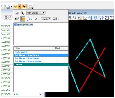

4.1 Levels Control
ISM files organize the contents into “levels” (levels  are the MicroStation term analogous to “layers” in AutoCAD™). The Levels control can be used to choose what is displayed graphically, which makes selecting items easier.
Levels Control in Structural Synchronizer
4.2 Sample Scenario – Brace Changes
In this scenario, a model has brace locations (in the physical structure that were not aligned by one of the centroid modeling options (refer to Section 3.2 and Section 3.3). When updating the ISM repository from the STAAD.Pro model, you might find unintended changes to the brace locations you want to reject. However, there may be other changes you may want to keep (e.g., material, section, etc.).
Use the following procedure to simplify rejecting changes:
  1. Use the Levels control to show only the Braces level.
  2. Select all the braces using the Element Selection tool.  Alternately, you could select only the modified ones, and skip Step 3.
  3. Select the Modified filter to show only modified items in the table.  Now the properties pane will show the properties of all of the modified braces.
  4. In the Properties table, reject the Location change.
Note: If the Location property is not editable (e.g., it is grayed-out and inactive), you will need to unselect any brace in the Objects pane that does not have the Location property changed before Step 4.

Appendix A – Descriptions of Individual STAAD.Pro Settings
A detailed description of each of the node generation options is given below
For import from ISM into STAAD.Pro, the Include Member Offsets setting causes STAAD.Pro to consider the Location, Placement Point and Section of the ISM member and convert those values into appropriate offsets from the node locations to place the STAAD.Pro member at its true physical location. If the setting is not used, STAAD.Pro places the member directly between its nodes.
For export from STAAD.Pro to ISM, the Include Member Offsets setting causes STAAD.Pro to consider the offsets to calculate the ISM Location for the member. If the setting is not used, STAAD.Pro sets the ISM Location for the member to be between the STAAD.Pro nodes.
There are four options for fixing (correcting) the nodes generated by ISM.
None – This option does not perform any correction.
Move Nodes to Analytical Lines – This option aligns the nodes in each member such that all the nodes are located on a line between the first and last node.

Tolerances for Fixing Nodes
This distance is the maximum separation between two member’s simplified (extruded rectangle) volumes that will trigger a node to be generated connecting the two members.
This distance is the maximum separation between two nodes that will always be merged together into a single node.
This distance is the maximum distance a node will be moved when performing the Move Nodes to Common Planes adjustment.
This factor is used to determine how far a node can be from a member and still be “reasonable” for the member. This reasonable test is used to determine if a member should be disconnected from a node (which may in turn cause the node to be deleted). The factor is multiplied by a distance based on the member’s largest cross section dimension, and the largest cross section dimension of any other member connected to the same node. The distances are measured from the centroid line of the members.
